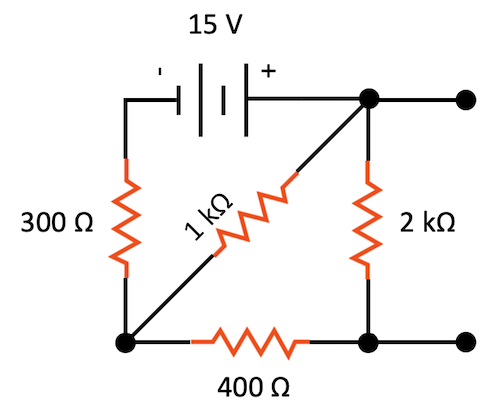

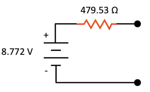

Convert this resistive network to its Thevenin equivalent:
Nothing but practice here. Have your students demonstrate how they did the Thévenin conversion, step-by-step.

I think there is an error in 8th question, Thevenin’s resistance must be 479.53 and not 210.53
