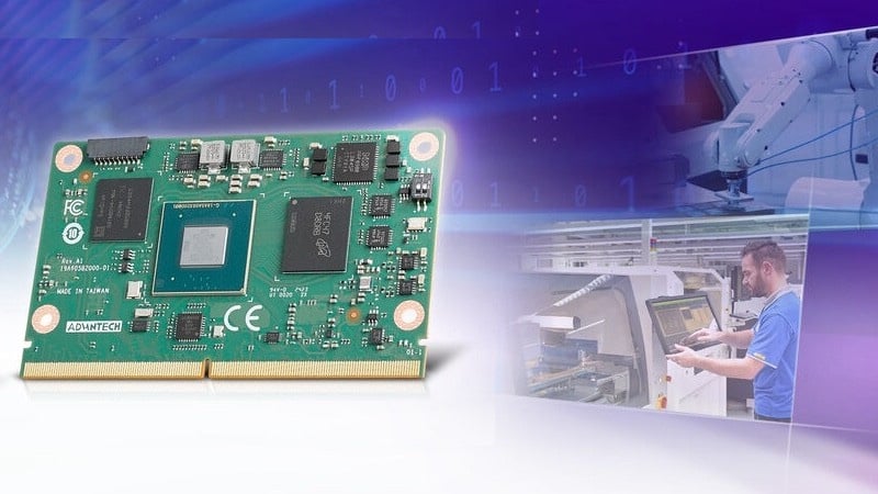

Advantech AOM-5521
Advantech recently released the AOM-5521 and AOM-2521, two computing modules based on the NXP i.MX95 platform. The AOM-5521 is an AI-on-Module platform built on NXP’s i.MX95 to offer a balance of compute performance, multimedia support, and real-time processing.
The module integrates six Arm Cortex-A55 cores clocked up to 2.0 GHz along with dedicated Cortex-M7 and Cortex-M33 cores for deterministic control tasks. AI inference is bolstered by a built-in neural network accelerator, while a 2D/3D graphics engine supports up to 1 Gpixel/s throughput with APIs including Vulkan, OpenGL ES 3.1, OpenCL 1.2 FP, and OpenVG 1.1. Hardware video encoding and decoding handle H.264 and H.265 up to 4Kp30.
Advantech’s AOM-5221 module is aimed at Intelligent Edge applications.
Advantech’s AOM-5221 module is aimed at Intelligent Edge applications. Image used courtesy of Advantech.
Memory is provisioned through 8 GB LPDDR5 running at 6400 MT/s, paired with 16 GB eMMC NAND Flash and 8 MB QSPI NOR for board information. Networking features include a 10 GbE port via USXGMII and dual Gigabit Ethernet through RGMII, while peripheral expansion supports dual PCIe 3.0 lanes, dual CAN-FD, five I2C channels, and fourteen GPIO. Display connectivity includes a four-lane MIPI-DSI and dual-channel LVDS, with HDMI available as an option.
The device comes with dimensions of 82 mm x 50 mm, industrial temperature ranges down to -40 °C, and TPM 2.0 security.

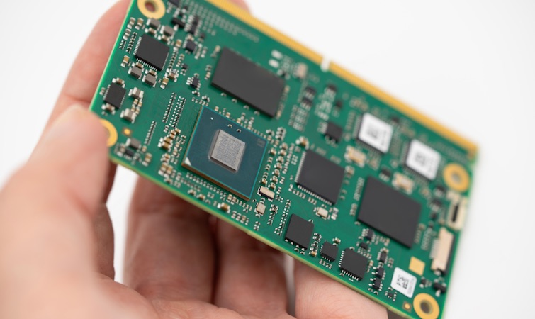

TRIA SM2S-G3E
The TRIA SM2S-G3E is a new SMARC 2.2-compliant computer-on-module built on the Renesas RZ/G3E system-on-chip. Designed for embedded human-machine interface and edge AI workloads, the device measures in at 82 x 50 mm and consumes 3-5 W depending on configuration. The module integrates up to four Arm Cortex-A55 cores operating at 1.8 GHz, paired with an Arm Cortex-M33 real-time processor at 200 MHz.
Selected variants incorporate the Arm Ethos-U55 NPU delivering up to 0.5 TOPS, alongside an Arm Mali-G52 GPU capable of 30 GFLOPS with support for OpenGL ES 3.2, Vulkan 1.2, and OpenCL 2.0. Video processing includes hardware-based H.265 4K encode/decode and H.264 1080p encode/decode.
The TRIA SM2S-G3E.
The TRIA SM2S-G3E. Image used courtesy of Tria.
The memory subsystem provides up to 8 GB of LPDDR4-3200 SDRAM with inline ECC and up to 256 GB of eMMC flash. Meanwhile, display options include dual independent outputs with LVDS, MIPI-DSI, and HDMI 2.0b options.
Networking features two Gigabit Ethernet interfaces with TSN and IEEE 1588 support, while peripheral connectivity includes PCIe Gen3, USB 3.2, USB 2.0, CAN-FD, I2S audio, and MIPI CSI-2 camera inputs.

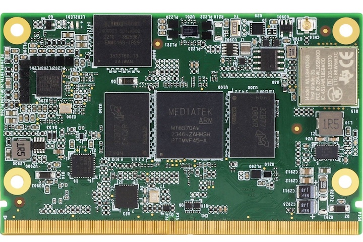

Aaeon uCOM-M700/M510
The Aaeon uCOM-M700/M510 is a SMARC 2.1-compliant CPU module built on MediaTek’s Genio platform.
The uCOM-M700 integrates the MediaTek Genio 700 (MT8390), combining two Cortex-A78 cores clocked at 2.2 GHz with six Cortex-A55 cores at 2.0 GHz. Meanwhile, the uCOM-M510 features the Genio 510 (MT8370) with two Cortex-A78 cores at 2.0 GHz and four Cortex-A55 cores at 2.0 GHz. Both variants use Mali-G57 GPUs, with the M700 offering a three-core configuration delivering up to 4 TOPS, while the M510 provides a dual-core GPU rated at 3.2 TOPS.
Aaeon’s uCOM-M700/M510 board.
Aaeon’s uCOM-M700/M510 board. Image used courtesy of Aaeon.
The modules integrate up to 8 GB of onboard LPDDR4 memory and eMMC 5.1 storage options ranging from 16 GB to 128 GB. They support multiple high-resolution display outputs, including HDMI 2.0, DisplayPort 1.4 at 4K60, eDP 1.2, and MIPI-DSI, with dual-display configurations up to 4K plus 2K. I/O expansion includes Gigabit Ethernet with TSN support, PCIe Gen 2.0, USB 3.0 plus five USB 2.0 ports, four UARTs, two MIPI-CSI interfaces, 12 GPIO lines, and five I2C controllers.
Operating over a temperature range of -40 °C to 85 °C, the module consumes 4.25 W and measures 82 mm by 50 mm.
