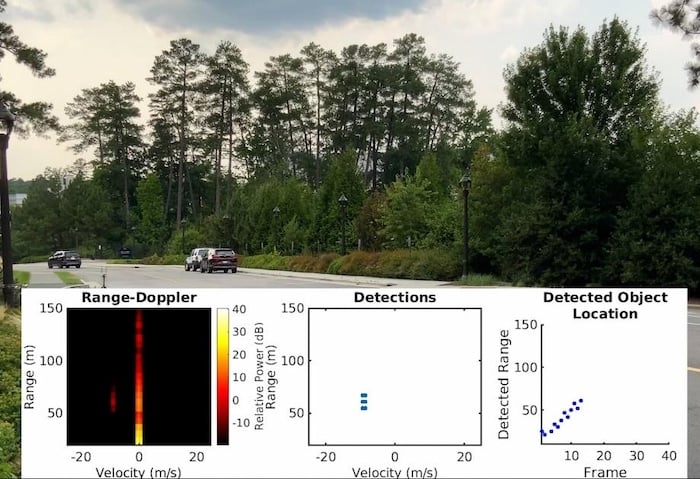

Duke University researchers have developed a system that can fool an automotive radar, removing its ability to detect car locations, as shown above. Image used courtesy of Duke University

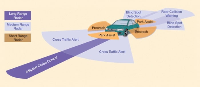

Automotive radar sensors use lower-frequency EM waves than light waves, allowing them to see in the dark, in poor visibility conditions, and in other scenarios where cameras may produce unclear images. Radar works as an EM counterpart to a flash camera, where the radar sends out an EM signal (or a “flash” in the case of a camera) and measures the reflected signals to learn about the sensing environment.
Radar serves many functions in modern vehicles, from park assistance to long-range measurement for adaptive cruise control. Image used courtesy of IEEE Signal Processing Magazine

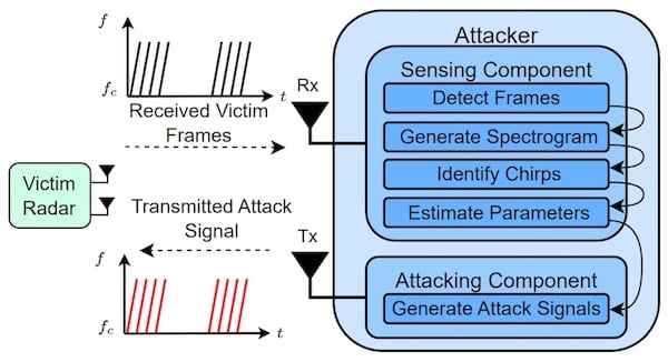

The MadRadar system can perform three attacks on a radar system: false positive (FP), false negative (FN), and translation attacks. In each case, the MadRadar system first learns about the victim radar by receiving its transmitted signals to find out the bandwidth, chirp time, and frame times.
Block diagram of MadRadar. Image used courtesy of ArXiv Preprint
FP attacks emulate the response of a car when one is not present. They can be performed by precisely attenuating and phase delaying the received signal to “confuse” the victim radar into thinking an object is within its range. Automotive OEMs have long known about these attacks, however, and have thoroughly tested against them in security test setups.

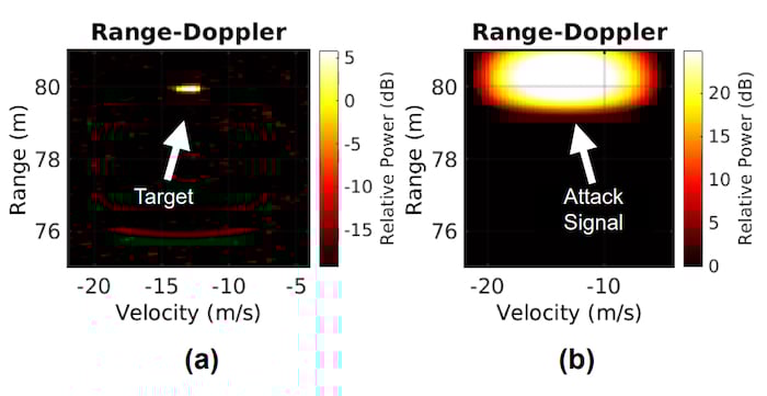

MadRadar’s FN attacks work by obscuring real targets with what appears to be large background noise (a). As a result, the (b) CA-CFAR algorithm cannot detect the real target. Image used courtesy of ArXiv Preprint
FN attacks, on the other hand, are a new feature Duke researchers introduced in their study. FN attacks leverage the CA-CFAR technique of automotive radar systems, where the effects of noise and clutter can be reduced. By emulating a broad target with no discernable peaks, the MadRadar can fool a victim radar into believing no target is present when there actually is one.

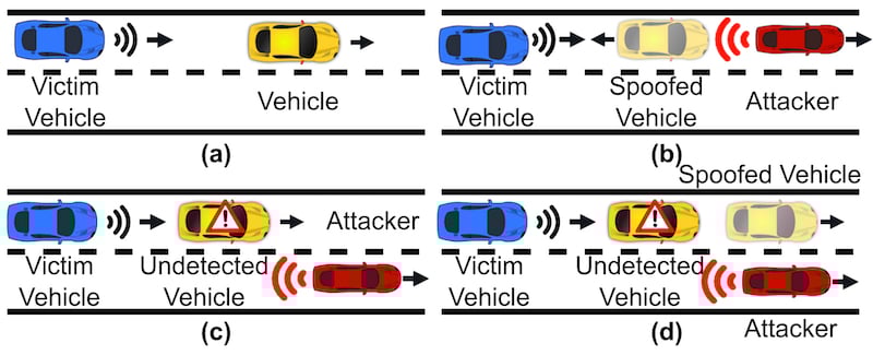

Example traffic scenarios for an (a) ao attack, (b) false positive attack, (c) false negative attack, and (d) translation attack. Image used courtesy of ArXiv Preprint
Finally, translation attacks indicate that a real object is moving in an unreal way. For example, an oncoming car could appear to be shifting into a driver's lane when, in fact, it is driving normally. From the car's point of view, however, this can warrant evasive actions that can cause great harm to the driver and pedestrians.
