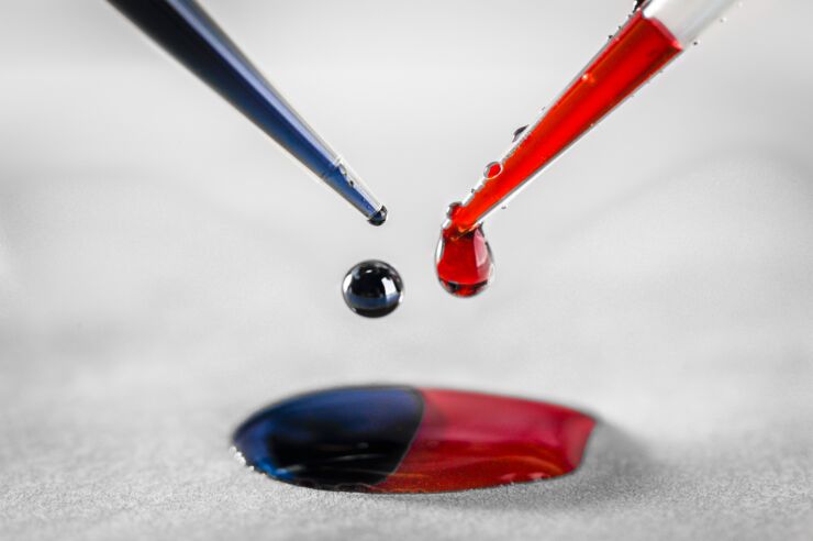

The mixed-polymer ink created by Linkoping University.
The polymer ink developed by Fabiano's team. The blue solution is the donor polymer solution and the red one is the accepter polymer solution. While both are non-conducting on their own, electrons from the donor polymer automatically transfer to the acceptor polymer when the solutions meet. Image used courtesy of Thor Balkhed of Linköping University.
