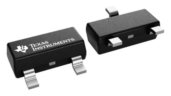

TL431
The TL431 is often called a "programmable Zener." Image used courtesy of Texas Instruments

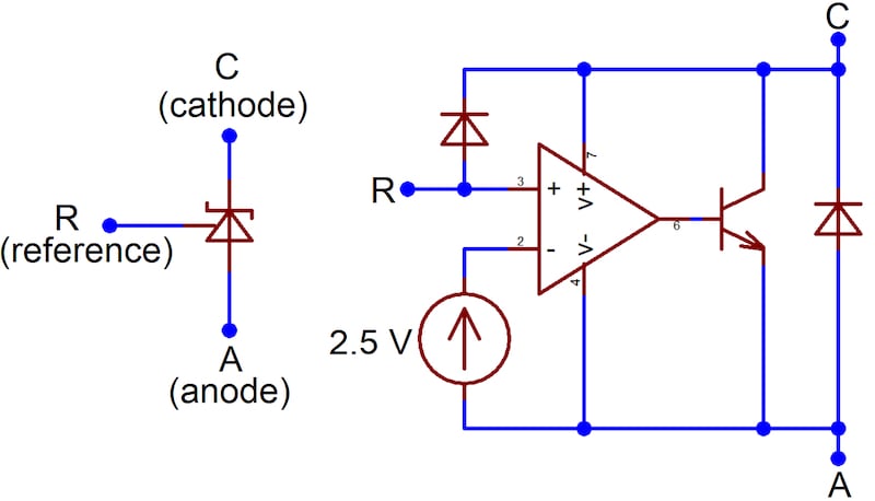

A simplified schematic of the TL431
A simplified schematic of the TL431. Image used courtesy of Wikimedia Commons (Public domain)
