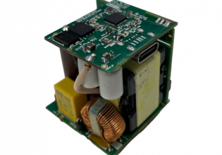

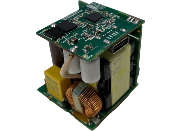

Infineon Technologies REF_65W_HFACF_PAG2 Compact 65W USB-C™ PD Charger
Infineon Technologies REF_65W_HFACF_PAG2 Compact 65W USB-C™ PD Charger was developed with PPS and legacy protocols. Infineon Technologies REF_65W_HFACF_PAG2 is supported by a range of 100VAC to 240VAC, and output voltages from 5V to 21V. The output power of this design is 65W and features an uncased power density of 32W/in³ based on EZ-PD™ PAG2-AC with high-frequency operation. The design is powered by Infineon CoolGaN™ (GS-065-009-6S-L) with an integrated lossless current sense feature.
FEATURES
  • Single port USB-C PD charger
  • High power density (uncased 32W/in³)
  • Support 65W output wattage
  • Support PD 3.1 PPS
  • Support BC 1.2, Apple charging, and QC 5.0
  • Support high-frequency operation
  • Wide input operation (100VAC to 240VAC)
  • Wide output voltage (5V to 21V)
  • Integrate x-cap discharge
  • Integrate VCC boost converter
  • Support firmware upgrade over CC lines
  • Highly integrated system solution
  • Meet DoE VI and CoC Tier2 requirement
  • Meet IEC62368 x-capacitor discharge
  • Meet EuP Lot6 requirement
  • Low standby power consumption of <30mW
  • Support firmware upgrade over USB-C
  • Capable of upgrading to PD 3.2 SPR PPS and AVS
