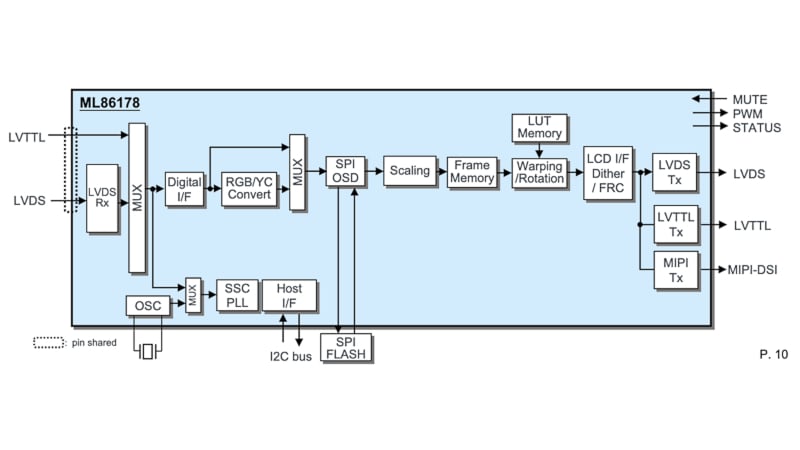

One benefit of the ML86178 HUD controller is its versatility in video interfacing, supporting both single and dual LVDS inputs at resolutions up to full HD. This enables smooth integration with a broad range of automotive SoCs and image sources that utilize LVDS interfaces. For legacy systems relying on parallel interfaces, the ML86178 can accept LVTTL input up to 1280 x 720 resolution, ensuring backward compatibility and smooth transitioning.
Block diagram of the ML86178 HUD controller. Image used courtesy of ROHM Semiconductor
On the output side, the ML86178 IC offers single and dual LVDS outputs, supporting resolutions up to 1920 x 1080. This allows designers to establish direct connection to high-resolution HUD display panels, eliminating the need for additional interface conversion stages. Moreover, the IC offers a MIPI DSI output option for integration with newer display technologies that leverage this high-speed interface. Overall, the ML86178's flexibility in output interfaces simplifies HUD system architecture and reduces the component count.

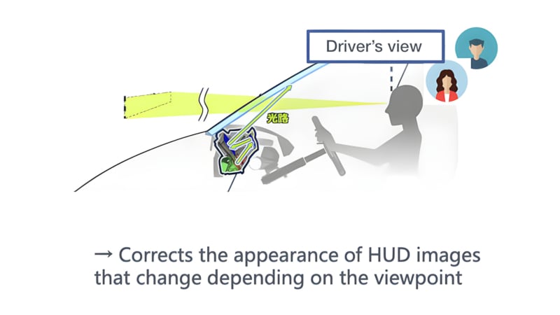

The ML86178 IC offers advanced image processing with a multi-region warping engine that can independently configure up to four distinct areas of the display. This allows precise geometrical transformations to be applied to specific regions for more accurate projection and alignment of HUD content. This warping engine supports high-precision coordinate transformation with a grid resolution ranging from 5x5 to 32x32 to minimize image distortion. This IC also incorporates an image processing pipeline that provides scaling, rotation, color space conversion, and gamma correction. The scaling and rotation engine achieves smooth and high-quality resizing of video content to match the resolution/aspect ratio of HUD displays, while color space conversion and gamma correction features enhance visual performance, color accuracy and contrast.
HUD content distortion correction with the ML86178 HUD controller. Image used courtesy of ROHM Semiconductor

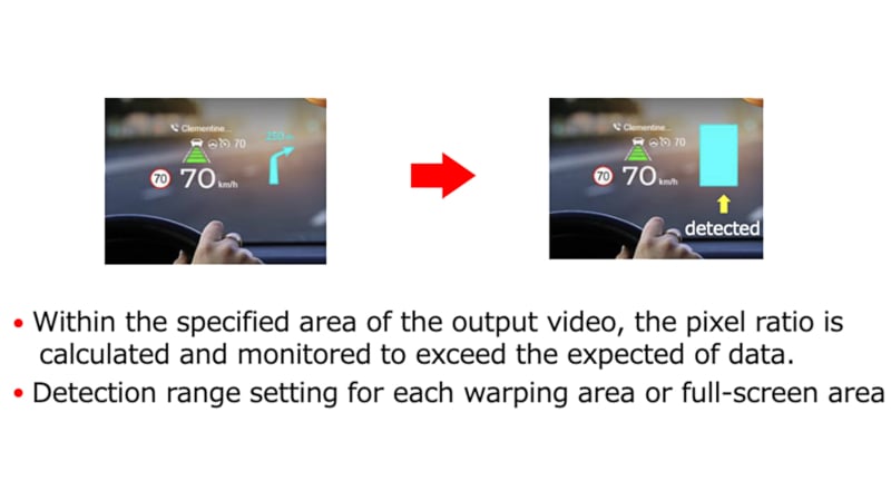

To meet the strict safety requirements of automotive systems, ROHM designed its ML86178 IC with a range of safety features. It continuously monitors input and output signals for anomalies, including frozen frames or signal loss, and also detects brightness abnormalities and occlusions in the display area. When an error condition is detected, it triggers error reporting and fail-safe mechanisms to ensure a safe and controlled system response.
Occlusion detection with the ML86178 HUD controller. Image used courtesy of ROHM Semiconductor
