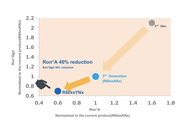

ROHM has introduced a line of 4th-generation Super Junction (SJ) MOSFETs, the R60xxYNx series, offering remarkable improvements over previous generation MOSFETs in terms of performance and efficiency. The key enhancement in the R60xxYNx SJ MOSFETs is the optimization of the device structure and fab process. Notably, ROHM has achieved a 40% reduction in the specific on-resistance (Ron*A) compared to 3rd generation SJ MOSFETs. This reduction translates into lower conduction losses and improved efficiency in a wide variety of PFC circuits.
Figure 1. 40% reduction in Ron*A compared to 3rd generation SJ MOSFETs
ROHM’s SJ MOSFETs can achieve up to a 30% lower figure of merit (FOM) for Ron*Qgd. Here, it’s important to note the gate-drain charge (Qgd) which impacts the switching performance of a MOSFET. A low value indicates faster transitions and reduced switching losses, which allows the R60xxYNx series to achieve high efficiency even at high switching frequencies.

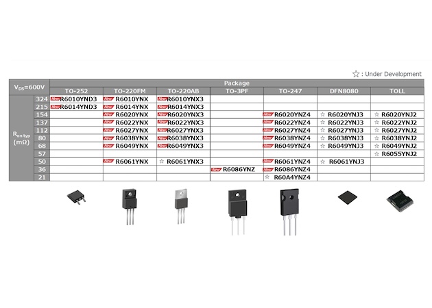

R60xxYNx Series Super Junction MOSFETs
ROHM offers a comprehensive lineup of SJ MOSFETs suitable for PFC applications. The series includes a broad range of ON-resistance values, ranging from 21 to 324 mΩ, catering to various power levels and efficiency requirements.
Figure 2. ROHM’s lineup of SJ MOSFETs

One of the main features of the R60xxYNx series is the high threshold voltage (Vth) rating. The higher Vth ensures lower switching-off losses, making these devices ideal for various BCM and DCM PFC designs. In these operating modes, the MOSFET turns off when the inductor current reaches zero, minimizing turn-off losses and contributing to overall efficiency. The R60xxYNx is available in popular package options, including through-hole and surface-mount. Through-hole options include TO-247, TO-3PF, TO-220AB and TO-220FM, which are suited for high-power applications and offer excellent thermal performance. Surface-mount types—TO-252—are more compact solutions for space-constrained applications. Additionally, ROHM is developing two new package options, the DFN8080 and TOLL, to further expand the flexibility available to engineers and designers.

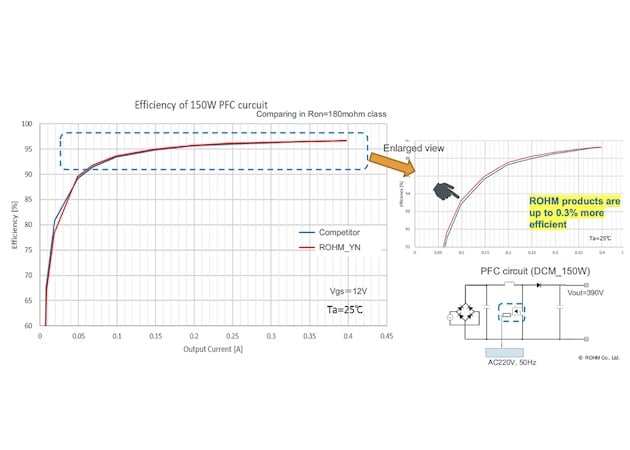

Figure 3. Efficiency improvement vs. competing 180 mΩ MOSFET
ROHM conducted rigorous application testing and benchmarking to validate the performance advantages of the R60xxYNx series in PFC applications. One notable evaluation is a 150W single-phase DCM PFC design, where the R60xxYNx MOSFET demonstrated a 0.3% efficiency improvement compared to a 180 mΩ MOSFET. Such efficiency gain is remarkable, considering the already high efficiency levels achieved in PFC circuits. The performance of the R60xxYNx series can be attributed to their lower on-resistance, fast switching speeds, and high Vth. These characteristics work synergistically to reduce conduction losses, minimize switching losses, and optimize the overall efficiency of the PFC circuit.
