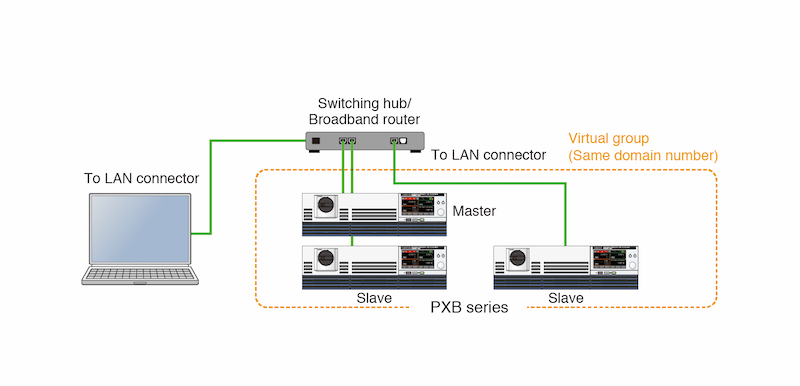

This function allows multiple DUTs to be connected concurrently for prototyping or product test scenarios, synchronizing multiple tests on different DUTs. To use this multichannel function, users can connect a PC to the PXB via a switching hub or a broadband router as shown in Figure 2.
Figure 2. To use the multichannel function, the PXB can be connected to a switching hub/broadband router, which is, in turn, connected to a PC.

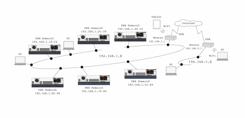

The series VMCB function allows the PXB to be used efficiently for remote control and monitoring with 1-to-N and as well as N-to-M in large-scale networks (Figure 3). The LAN interface is LXI compliant, allowing users to control and monitor the PXB from a browser on a PC, smartphone, or tablet. The power supplies can also be managed from a different building. This function greatly scales the reach of production testing, controlling all automated tests from a single device.
Figure 3: The virtual group (with the same domain number) can be part of a larger-scale N-to-M network, extending the number of PXB tests that can be performed simultaneously on DUTs.

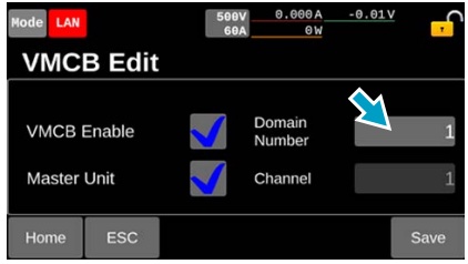

Commands can be sent from the PC to control the PXB by setting the following functions (Figure 4):
VMCB enable: Enabling virtual multichannel bus (VMCB) function (System → VMCB → Edit).
Master/slave unit: Setting up the master and slave units on the PCB connected to multichannel. The PXB unit set at the VMCB slave units are controlled by the VMCB master unit.
Domain number: PXB units that have the same domain number can be controlled as one VMCB network.
Channel: Channel numbers are used to identify each VMCB slave unit when they are controlled from the PC using commands.
Figure 4. The VMCB window can be accessed under “System” on the PXB to enable the multichannel function.

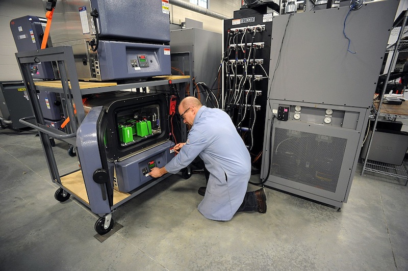

Massive testing labs for batteries can include thousands of cycling channels and hundreds of environmental chambers (Figure 5). These labs require a centralized method of control across devices to synchronize, thus simplifying testing. The PXB assists with the process of scaling up testing with minimal complexity, lowering the barriers for testing multiple DUTs.
Figure 5. The Idaho National Laboratory’s (INL) battery testing lab. Source: Wikimedia Commons
