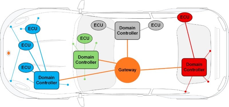

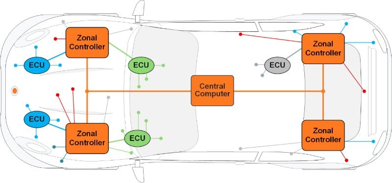

Figure 1. Domain Architecture (top) and Zonal E/E Service Oriented Architecture (bottom).
Traditionally, vehicle electronics were organized into functional domain blocks (powertrain, chassis, HVAC, lighting, etc.), each with its own control units and wiring network. Domain architecture evolved from legacy centralized architecture, in which power was delivered directly to individual electronic control units (ECUs). On the other hand, in domain architecture, the power is delivered to domain controllers and from them to the respective ECUs. The problem is that each added function requires its own ECU, wiring harness, and software. The wiring harness connecting everything becomes longer and heavier, and software integration becomes difficult. The ECUs and domains use a plethora of communication standards such as LIN, CAN, and FlexRay, while in-vehicle central communication is based on Ethernet. Therefore, gateways are required between various communication standards, increasing costs and complexity. This architecture is not sustainable as complexity and intelligence continue to increase.

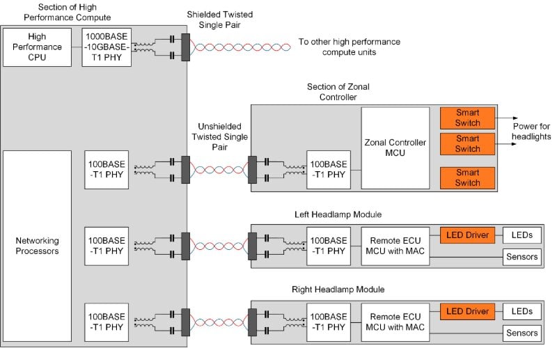

Using point-to-point Ethernet architecture (Figure 2), although it improves speed and removes gateways, is not an ideal solution because it requires a large number of PHYs, increasing system costs. This architecture requires complex switch management of connections, and each ECU is connected directly to the CPU, which increases wiring harness complexity.
Figure 2. Automotive Ethernet Point-to-Point Connections.

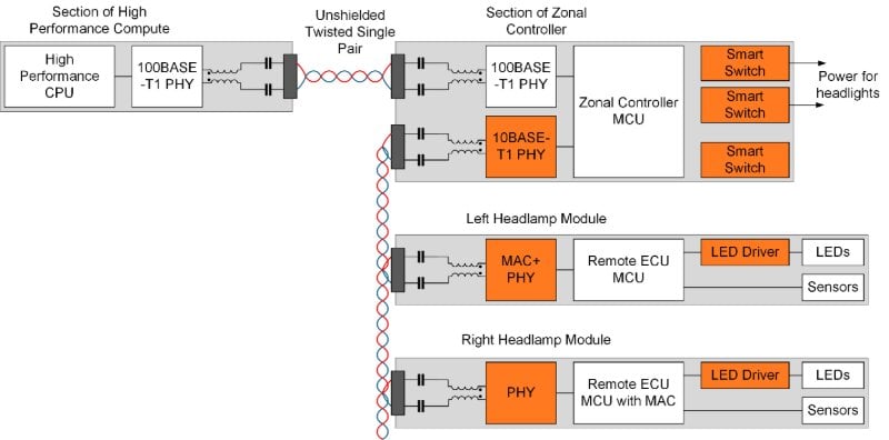

The use of a multi-drop Ethernet topology (Figure 3) simplifies wiring and saves space, translating to less weight and system costs. In a 10BASE-T1S LAN, any node can send and receive frames to and from any other node.
Figure 3. Automotive Ethernet Multi-Drop Connections.

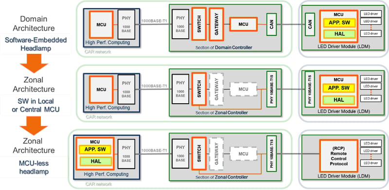

Remote Control Protocol (RCP) is a lightweight communication technology, aimed to ease the transition towards zonal architecture and the simplification of the overall IVN towards an All-Ethernet approach. With the use of RCP, complexity can be shifted toward a reduced number of centralized computing platforms, hence reducing the size, complexity, and cost of peripheral devices.
RCP is essentially a communication interface that lets a central computer directly control peripheral devices (like LED drivers, sensors, motors) over a single-pair Ethernet network. An RCP controller acts as a bridge, converting Ethernet data to local control signals (SPI, PWM, I²C, etc.) without needing a host MCU at the device. This allows a headlamp to be part of the Ethernet network as a node, receiving high-level commands from the central unit. Importantly, RCP is being standardized via the OPEN Alliance to ensure an open, interoperable protocol for all automakers and suppliers.
RCP removes the need for a dedicated MCU and software in the lamp, reducing hardware complexity and shortening development cycles and time to market. The RCP-based architecture and its comparison to the domain and zonal architectures are visualized in the figure. Compared to the legacy architecture, all of the high-performance computing and the hardware abstraction layer (HAL) are located outside of the lamp. Whereas in the past the LED driver module (LDM) would receive simple commands to control functions (e.g., low beam on), in the MCU-less paradigm, the LDM receives direct commands to switch specific LEDs or LED strings.
Figure 5. Lighting Architecture.
