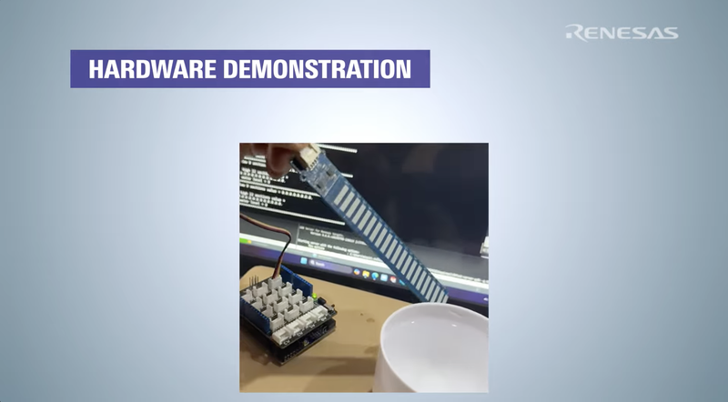

The Grove Water Level Sensor connected to the FPB-RA0E1 and lowered into a container of water.
Figure 1. The Grove Water Level Sensor connected to the FPB-RA0E1 and lowered into a container of water. Image used courtesy of Renesas

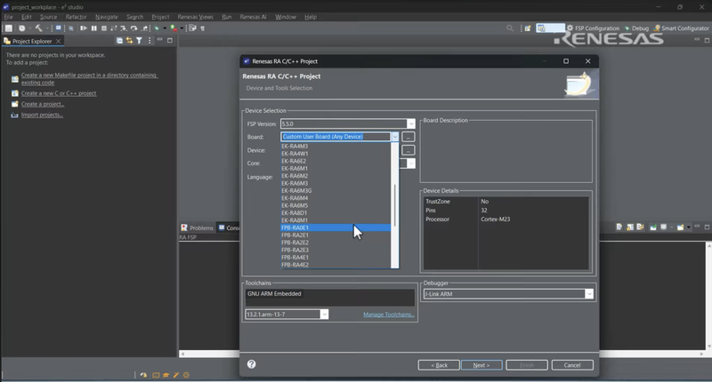

Step 2: Create a Minimal Bare Metal Project
  1. Click the file icon in your e² studio IDE, select New, select Renesas C/C++ Project, select Renesas RA, and then select C/C++ Project.
  2. Name the project Water_level_sensor and target the FPB-RA0E1 board using FSP version 5.5.0.
  3. Select a Flat (Non-TrustZone) Project structure, choose the Executable and No RTOS options, and select the Bare Metal Minimal template.
Selecting the FPB-RA0E1 board with FSP 5.5.0 in the e² studio new project wizard.
Figure 2. Selecting the FPB-RA0E1 board with FSP 5.5.0 in the e² studio new project wizard. Image used courtesy of Renesas
Starting with a minimal template removes unnecessary operating system overhead so you can focus entirely on the I2C peripheral configuration.

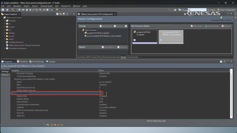

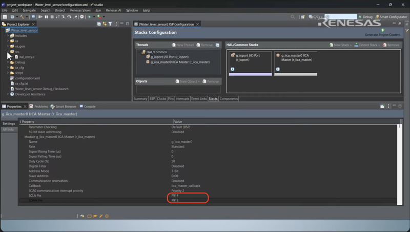

Step 3: Add and Configure the IICA Master Stack
  1. Open the FSP Configuration perspective. Navigate to the Stacks tab, click New Stack, select Connectivity, and click IIC Master (r_iica_master).
  2. In the Properties window, change the Duty Cycle to 50%. Assign the SCLA Pin to P914 and the SDAA Pin to P913.
  3. Click Generate Project Content.
Setting the duty cycle to 50% in the IICA master stack properties.
Figure 3. Setting the duty cycle to 50% in the IICA master stack properties. Image used courtesy of Renesas
Assigning the SCLA pin to P914 and the SDAA pin to P913 in the IICA master stack properties.
Figure 4. Assigning the SCLA pin to P914 and the SDAA pin to P913 in the IICA master stack properties. Image used courtesy of Renesas
Because microcontroller pins are multiplexed, you must explicitly route the internal I2C peripheral to specific physical pins in the FSP. If these pin assignments do not match the headers where you connect your jumper wires, the clock and data lines will remain electrically disconnected from the sensor.

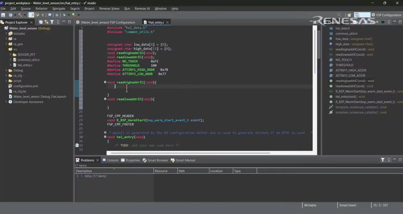

Step 4: Define Variables and Include Headers
  1. Open hal_entry.c in your src folder. Include common_utils.h to enable the RTT terminal printing.
  2. Declare global data buffers for the low and high I2C reception arrays (low_data and high_data), initializing them to {0} with sizes 8 and 12 respectively. Add the THRESHOLD (100) and NO_TOUCH (0) macros. Define the slave addresses as macros (ATTINY1_HIGH_ADDR as 0x78 and ATTINY2_LOW_ADDR as 0x77).
  3. Finally, declare a volatile event variable to track the I2C callback status and set a timeout_ms variable to 30 for your read loops.
The include files, data buffers, and address macros declared at the top of hal_entry.c.
Figure 5. The include files, data buffers, and address macros declared at the top of hal_entry.c. Image used courtesy of Renesas
The sensor returns its data in two separate I2C transactions from two different slave addresses. Dedicated buffers for each transaction prevent the second read from overwriting the first, and the event tracker lets each read function know when its transfer has finished.

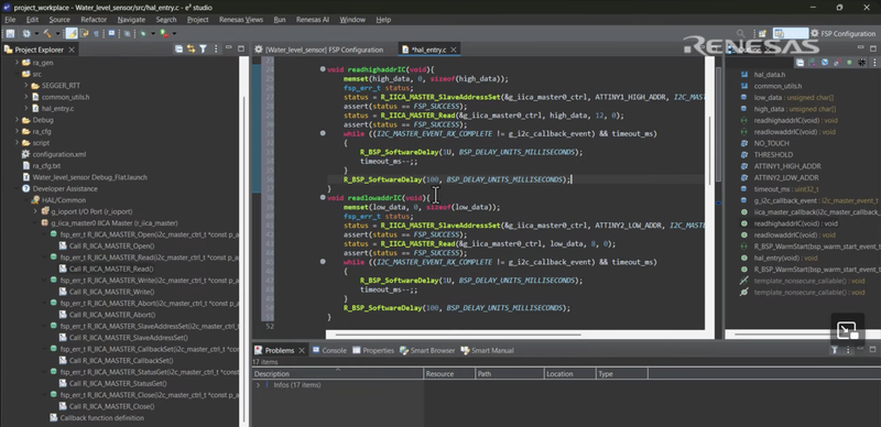

Step 6: Create the I2C Read Functions
  1. Define two functions named readHighAddrIIC and readLowAddrIIC. Inside each, use memset to clear the data buffer.
  2. Drag and drop R_IICA_MASTER_SlaveAddressSet from Developer Assistance to target the appropriate slave address, followed by R_IICA_MASTER_Read to request the bytes.
  3. Add a while loop that checks your event variable to wait for the reception to complete, then subtracts from your timeout variable during a 100 millisecond R_BSP_SoftwareDelay.
The readHighAddrIIC and readLowAddrIIC functions set the slave address, read the data, and wait for each transfer to finish.
Figure 6. The readHighAddrIIC and readLowAddrIIC functions set the slave address, read the data, and wait for each transfer to finish. Image used courtesy of Renesas
Dynamically updating the slave address before executing a read allows a single I2C bus master to query multiple devices sequentially.

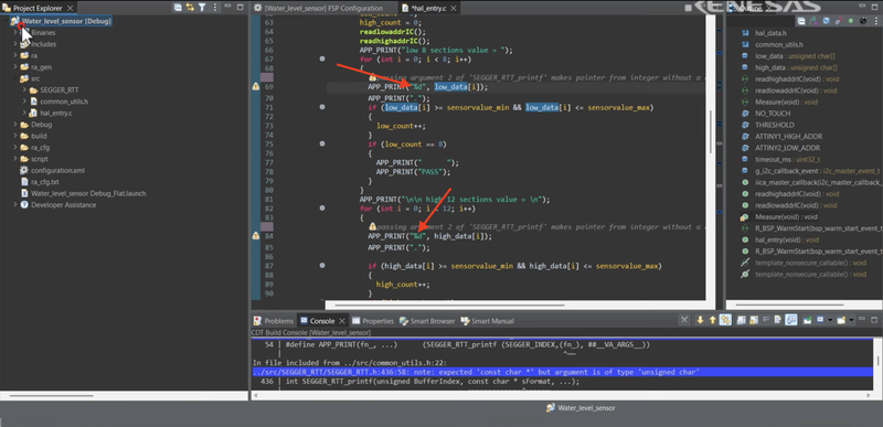

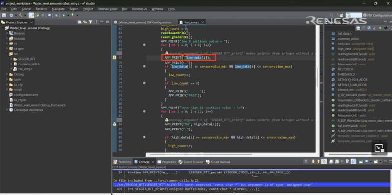

Step 9: Build and Fix Format Specifiers
  1. Click the hammer icon to build the project. The compiler will throw warnings about the APP_PRINT formatting strings. Ensure you are using the %d identifier to print your integer variables on the RTT terminal. Build again to confirm zero errors and zero warnings before launching your debug session.
The warning occurs because the array index was missing (passing a pointer instead of an integer), which is resolved by appending [i] to the data variables.
Appending [i] to low_data in the APP_PRINT call resolves the format specifier warning.
Figure 7. Appending [i] to low_data in the APP_PRINT call resolves the format specifier warning. Image used courtesy of Renesas

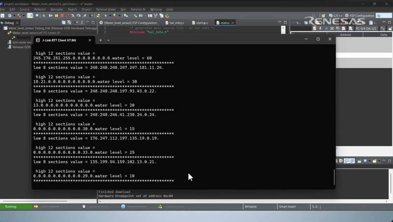

What You Should See
After building the project and launching the Renesas GDB Hardware Debugging perspective, open your J-Link RTT Client. The terminal begins continuously printing the live output arrays. When the sensor is dry, every pad reads well below 100 and the water level prints as 0. As you lower the sensor into water, each covered pad jumps to roughly 245 to 255, and the level climbs in steps of 5.
The J-Link RTT Client prints the pad values and the water level as the sensor is lowered into water.
Figure 8. The J-Link RTT Client prints the pad values and the water level as the sensor is lowered into water. Image used courtesy of Renesas

Build Fails With a Warning About Format Specifiers
Ensure you are using the correct %d identifier in your APP_PRINT formatting strings to print integer variables. This warning occurs because the array index was missing (passing a pointer instead of an integer). Resolve this by appending [i] to your low_data and high_data variables.
The compiler flags the APP_PRINT calls where the array index is missing.
Figure 9. The compiler flags the APP_PRINT calls where the array index is missing. Image used courtesy of Renesas
