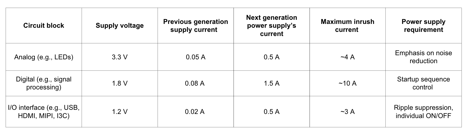

These DUTs often include analog power, digital, and I/O circuits that must be powered up in a defined sequence to ensure safe operation. In addition, inrush currents during power-up and power-down are typically staggered to reduce stress on the DUT. Shown in Table 1, each circuit may also require its own startup sequence and inrush-current control. This necessitates the use of multiple benchtop power supplies that support sequencing, delay, and soft-start/soft-stop functions.
Table 1: Common DUT subsystems with example supply voltages and currents for previous- and next-generation variants, along with their corresponding maximum inrush current values.

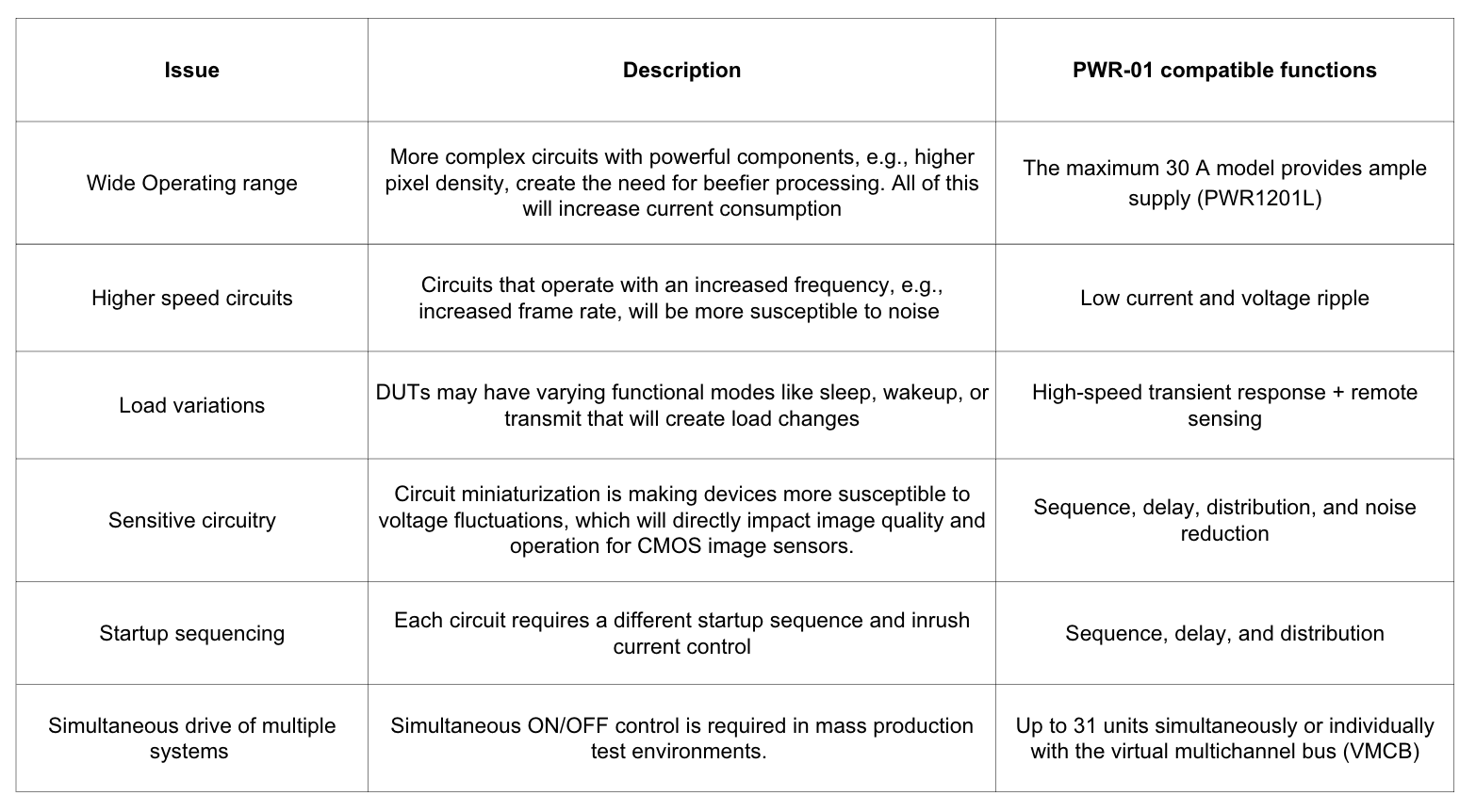

Table 2 summarizes the challenges associated with testing next-generation electronics and the corresponding benchtop power supply functions needed to address them. It also identifies the Kikusui PWR-01 features that support these requirements.
Table 2: The challenges of testing next-generation electronics, the respective functions necessary from the benchtop power supply, and the compatible functions in the Kikusui PWR-01 power supply.

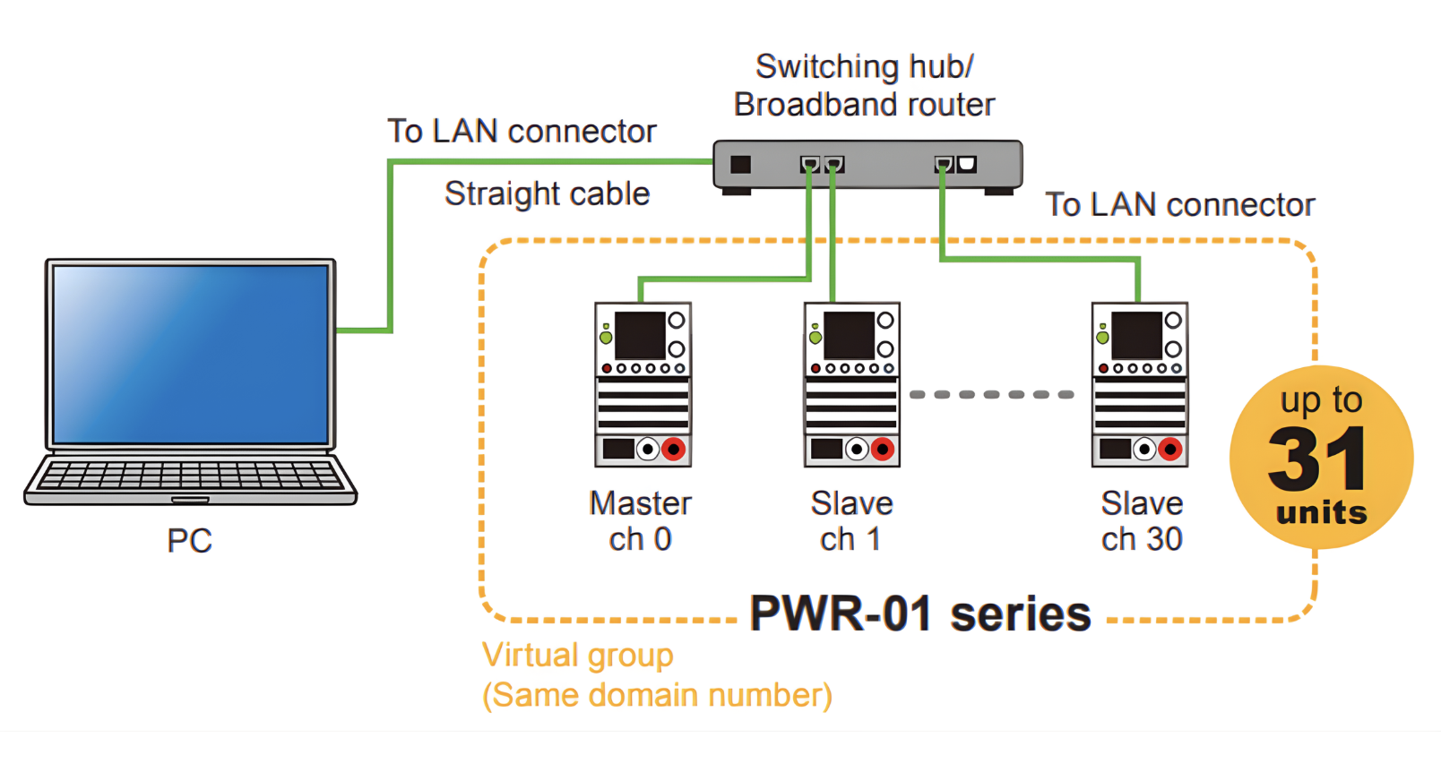

The PWR-01 enables control of up to 31 units per group across 254 test stations. In total, up to 7,874 units can be synchronized for production testing using the VMCB function (Figure 2). This functionality includes extensive protection features and fully supports on-site requirements, including sequencing, presets, and remote sensing. Bulk ON/OFF automation is supported, which streamlines evaluation procedures and enhances test reproducibility by minimizing errors. Figure 2 illustrates the VMCB function in action, where a single PC can control up to 31 PWR-01 units, effectively creating a virtual multi-channel power supply system.
alt_text
Figure 2: The VMCB function is practical for matching the control timing of multiple PWR-01 units, ensuring test uniformity. Source: Kikusui
During development, evaluation of jigs and PCs are frequently replaced. Replacing conventional power supplies in this process is burdensome, as they typically require drivers and dedicated software, resulting in higher costs and longer setup times. In contrast, the VMCB function requires no drivers, connects via LAN, and can be restarted immediately without additional configuration. This ensures that on-site operations continue uninterrupted in the event of an issue. Moreover, the VMCB function delivers consistent results regardless of operator variation, thus standardizing workflows and reducing training requirements. As production needs to evolve, future line expansions and configuration changes are easily managed through reconfiguration of the central unit. This approach helps future-proof the power supply installation for mass production environments.

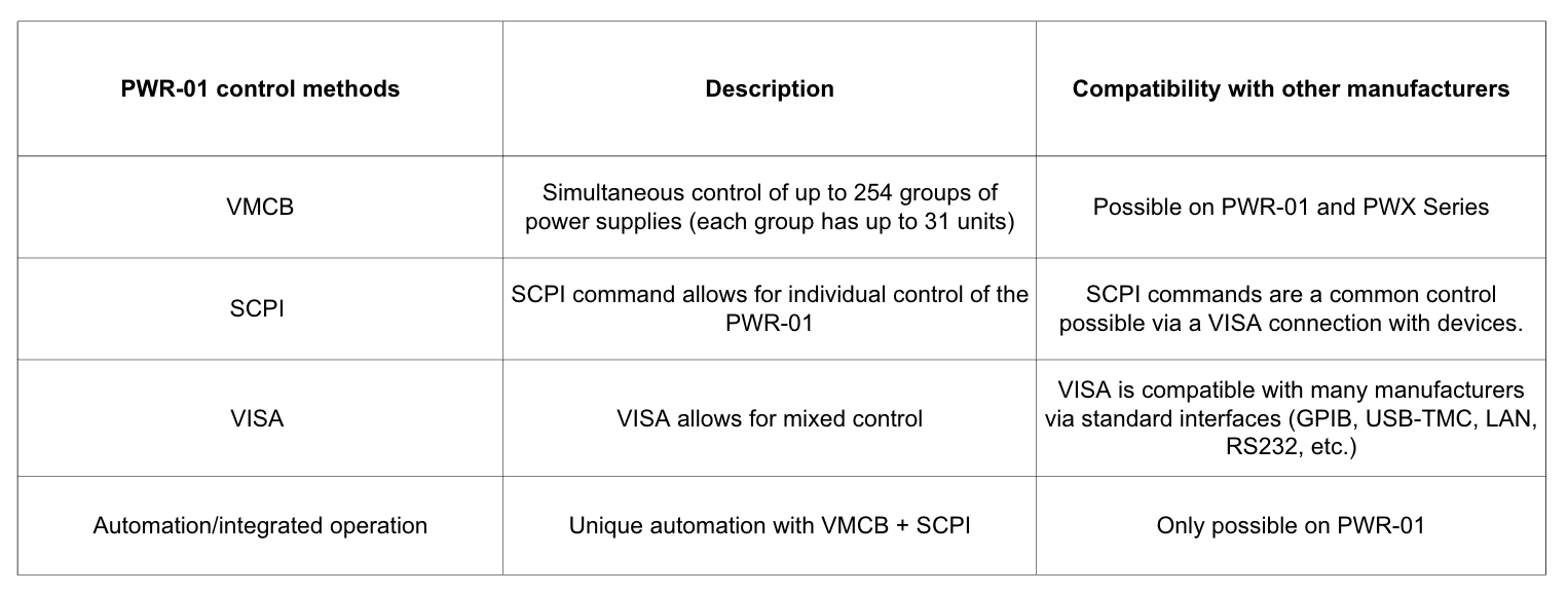

The PWR-01 also supports industry-standard multi-channel control options, including SCPI and VISA, as detailed in Table 3. While VMCB provides the greatest testing flexibility at scale, some customers may prefer not to be tied to a single vendor’s ecosystem. The PWR-01 supports widely used VISA and SCPI control methods with established VISA libraries. Hybrid control combining VMCB and SCPI is also possible, simplifying the management of a testing infrastructure that incorporates instruments from multiple T&M vendors.
Table 3: The various PWR-01 control methods for flexibility in scalable deployments.
