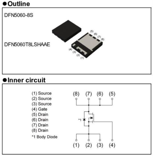

Rohm’s Power MOSFETS for AI Servers
The 24/7 operation of AI servers places a great amount of stress, such as heat, shock, and vibration, on electronic components. To lower heat generation and de-stress server racks, Rohm developed a new generation of N-channel power MOSFETs.
Specifically optimized for AC-DC conversion with minimum power losses, the devices introduce a DFN5060-8S package that expands die area by 65% compared to conventional HSOP8 packages of the same size. The result is lower RDS(on) and improved thermal performance. With this package, the RS7E200BG (30 V) achieves 0.53 mΩ RDS(on) at VGS = 10 V, while the RS7N200BH (80 V) achieves 1.7 mΩ, both setting benchmarks in their class.
The package and pinout of RS7N160BH.
The package and pinout of RS7N160BH. Image courtesy of ROHM
According to Rohm, the chip was also designed to improve heat dissipation and increase safe operating area (SOA) tolerance, the range of voltage and current within which a device can operate safely without damage. With increased SOA, the RS7E200BG now supports over 70 A at VDS = 12 V with a 1 ms pulse, doubling the SOA of prior designs.
