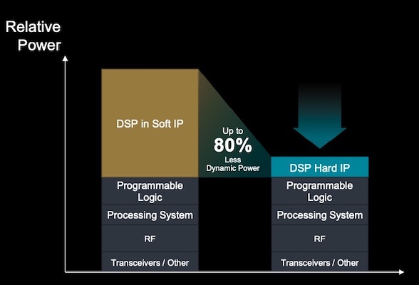

A defining feature of the Versal RF series is its focus on power efficiency, achieved by strategically using hard IP for computationally intensive tasks. According to AMD, implementing DSP functions such as FFTs and LDPC decoders in hard IP reduces power consumption by up to 80% compared to traditional soft logic implementations.
AMD claims that hard IP reduces dynamic power by up to 80%
AMD claims that hard IP reduces dynamic power by up to 80%.
The monolithic integration of analog and digital components further contributes to efficiency. By eliminating chip-to-chip interfaces, such as JESD204 links, the devices avoid additional power overhead associated with high-speed interconnects. This integration also reduces latency since data no longer needs to traverse multiple chips for processing. AMD also claims that the single-chip design simplifies the system architecture and improves signal integrity by reducing potential noise and interference.
