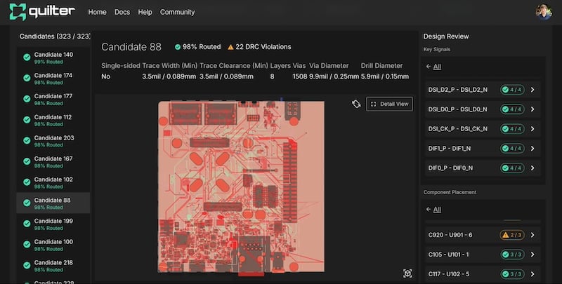

At the core of Project Speedrun is Quilter’s physics-driven AI engine, which treats PCB layout as a constrained optimization problem rather than a rule-based automation task. Instead of relying on predefined placement heuristics or post-route cleanup, the system evaluates signal integrity, power integrity, thermal behavior, and electromagnetic coupling concurrently during component placement and routing.
Each viable candidate is determined by the AI engine and displayed in a GUI format
Each viable candidate is determined by the AI engine and displayed in a GUI format.

A notable aspect of the demonstration is the limited need for manual intervention. After initial schematic import and constraint definition, the AI-generated layouts required only minor human review and adjustment before tape-out. Within Project Speedrun, the candidate tool systematically organizes large numbers of possible design configurations into a manageable set of viable options. These “candidates” represent specific combinations of topology, routing, and constraint choices that have a realistic chance of meeting performance requirements.
