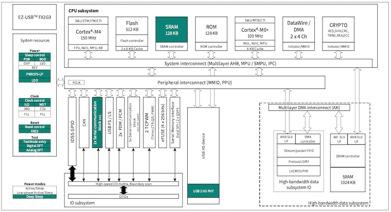

The FX2G3 (datasheet linked) uses two CPU cores: a 150-MHz Arm Cortex-M4F and a 100-MHz Cortex-M0+. USB traffic and data movement run on one core, while application code and peripheral control run on the other. Keeping these tasks separate helps reduce bottlenecks and makes data transfer timing more stable during continuous, high-speed operation.
Block diagram of Infineon’s EZ-USB FX2G3 USB 2.0
Block diagram of Infineon’s EZ-USB FX2G3 USB 2.0 peripheral controller.
The FX2G3 will also include six configurable serial communication blocks that can be set up as SPI, I²C, or UART. These interfaces connect sensors, codecs, and other control devices. For higher data rates, the GPIF III interface provides a parallel LVCMOS connection with up to 16 data lines plus clock and control signals. Running at up to 100 MHz in both transmit and receive modes, the GPIF III is intended for direct links to cameras, ADCs, and other high-speed data sources.

The FX2G3 features a high-bandwidth data subsystem that transfers data from the parallel LVCMOS interface to USB endpoints at speeds up to 480 Mbps. To keep transfers efficient and avoid CPU usage, it uses 1,024 KB of dedicated SRAM as a buffer between the data source and the USB interface.
This buffer lets the FX2G3 handle large data blocks within the chip, helping prevent underruns during streaming and reducing the timing demands on the firmware. For devices such as scanners, cameras, and data-acquisition systems, on-chip SRAM can replace external buffer memory, simplifying PCB layout and reducing power and signal-integrity issues. The EZ USB FX2G3 also has 512 KB of application flash, 128 KB of general-purpose SRAM with retention control, and 128 KB of ROM for initialization, security, and flash programming.

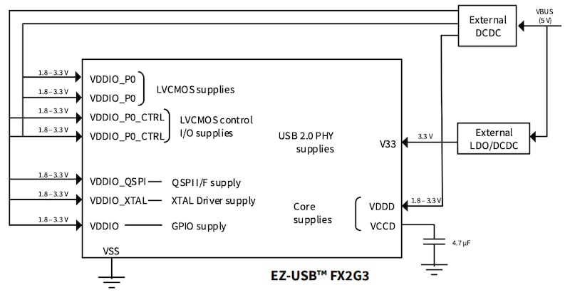

The FX2G3 operates over a 1.7 V to 3.6 V voltage range and features power control with deep-sleep modes to retain SRAM. Individual peripheral I/O blocks can be powered down when not in use. This kind of control is useful in designs that need to move a lot of data when active but still keep average power in check, such as portable medical devices or battery-backed measurement equipment.
