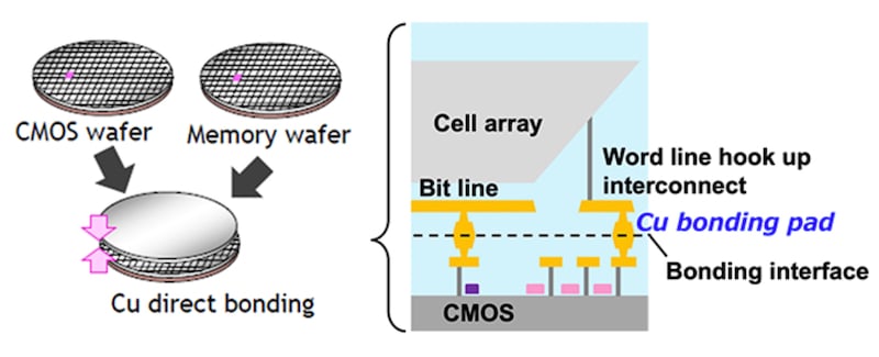

Kioxia used CMOS‑Directly‑Bonded‑to‑Array (CBA) wafer bonding to develop this memory technology. This bonding technique fabricates logic circuitry and cell arrays separately under optimal conditions and vertically joins them together.
CBA wafer bonding technology
CBA wafer bonding technology.
The cell array refers to the part of the NAND flash memory that physically stores the data. It consists of millions of individual memory cells, each capable of holding an electrical charge to represent bits: 1s and 0s. These cells are arranged in a grid-like structure, stacked vertically in 3D NAND, and grouped. This enables high‑temperature processing on the memory side without degrading the CMOS, boosting both performance and yield.

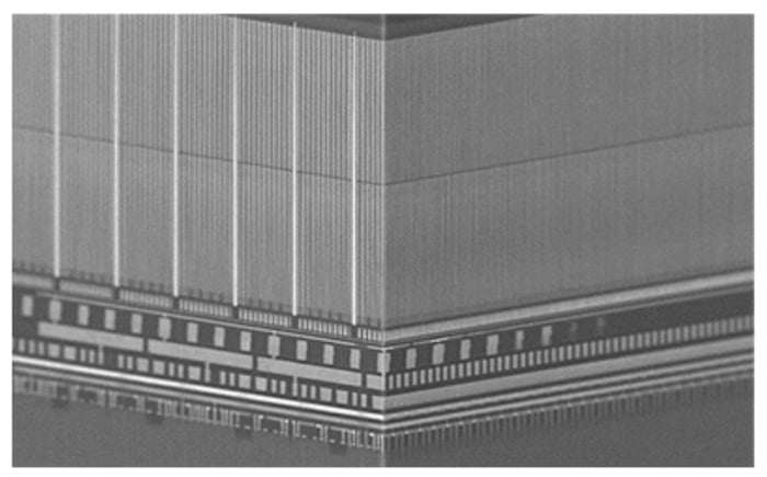

Kioxia claims such architectural advances deliver notably higher gigabyte density, faster I/O, and efficiency for operation in demanding environments like automotive systems and data centers. In these environments, memory must withstand sustained high throughput without overheating and maintain long-term reliability. Kioxia posits BiCS Flash as a solution to meet these demands without sacrificing efficiency or scalability.
Electron microscopy image of the 8th-generation BiCS Flash
Electron microscopy image of the 8th-generation BiCS Flash.
