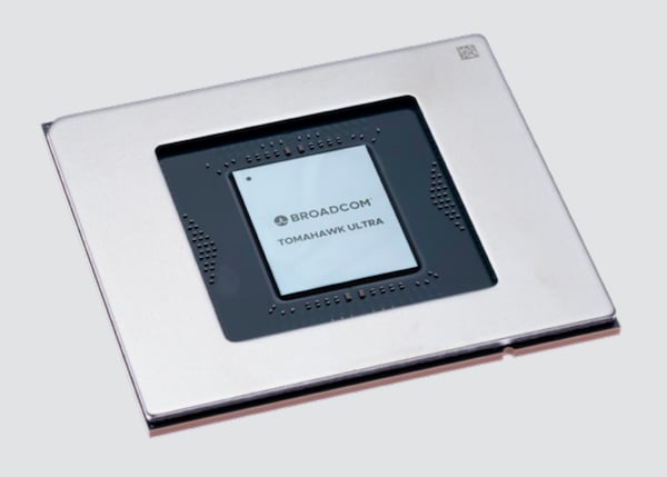

The company led Jalapeño's architectural design, drawing on its daily observations of inference patterns across ChatGPT, Codex, and its API. Broadcom handled silicon implementation and contributed its Tomahawk networking silicon to bring the platform to large-scale production. Celestica provided board, rack, and system expertise to industrialize the design. Together, the three companies built Jalapeño from scratch on a 3-nm process, tailored to the specific memory movement, compute, and networking patterns of LLM inference.
Broadcom's Tomahawk Ultra Ethernet switch
Broadcom's Tomahawk Ultra Ethernet switch series. Image used courtesy of Broadcom
