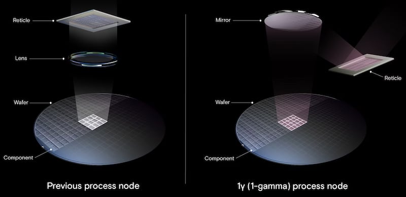

Built using Micron’s most advanced 1γ node, the LPDDR5X memory achieves data rates up to 10.7 Gbps, a substantial jump over the 7.5 Gbps ceiling of its 1β predecessors. These gains are underpinned by the adoption of high-k metal gate transistors and extreme ultraviolet lithography, which provide tighter control over leakage and enable denser bitline and wordline spacing with improved pattern fidelity. At the transistor level, this translates into reduced parasitic capacitance and more efficient access switching—key parameters when balancing high-speed I/O with strict power budgets.
