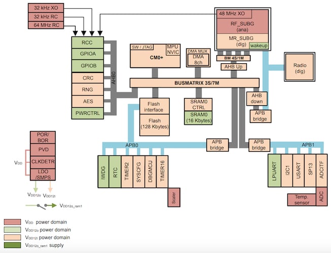

The STM32WL3RK8 (datasheet linked) is built around a Cortex-M0+ running up to 64 MHz, paired with 64 KB of flash and 8 KB of SRAM. Its defining feature is the integrated sub-GHz RF transceiver, which supports multiple modulation schemes including 2-FSK, 4-FSK, OOK, and ASK across regional ISM bands around 315 MHz, 433 MHz, and the 800–900-MHz range.
Block diagram of the STM32WL3Rxx
Block diagram of the STM32WL3Rxx. Image used courtesy of STMicroelectronics
Power modes are aggressive, with sub-µA current in deep sleep and nA-scale shutdown, along with six independent wake-up pins. The peripheral set is modest and typical for low-power control and wireless nodes, with basic timers, SPI, I²C, and UART.

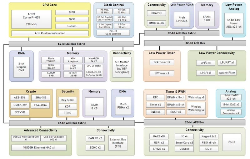

At the opposite end of the spectrum, Nuvoton's NuMicro M5531 (datasheet linked) is built on a Cortex-M55 core running up to 220 MHz, with vector extensions for DSP-class workloads.
Block diagram of the NuMicro M5531
Block diagram of the NuMicro M5531, including a Cortex-M55 core for high-performance DSP-class workloads. Image used courtesy of Nuvoton
It carries megabyte-class flash and SRAM, placing it in a different memory tier than the other two devices. Its peripheral set is also far broader, extending to USB, Ethernet, CAN-FD, SDHC, high-speed serial interfaces, and a full security subsystem with hardware crypto and secure boot. Unlike the ST and Infineon devices, it includes neither an RF transceiver nor a high-voltage analog front end, instead positioning itself as a high-throughput embedded processor for data-heavy edge applications.

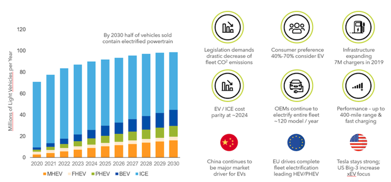

Taken together, these three devices highlight how the MCU market is expanding sideways rather than moving along a general industry standard for performance. On the low end of the power spectrum, demand for long-life wireless endpoints continues to grow across consumer electronics, building automation, and asset tracking, all of which favor highly integrated sub-GHz solutions like the STM32WL3RK8. At the same time, electrification is pushing new requirements deep into the vehicle, where battery management has become both a safety and a system-architecture problem.
Chart showing the increasing electrification of vehicles by 2030
Chart showing the increasing electrification of vehicles by 2030. Image used courtesy of NXP
Devices like the PSOC 4 HVPA-SPM 1.0 reflect how monitoring, communication, and diagnostics are being pulled directly into the battery pack as zonal control spreads through EV platforms.
