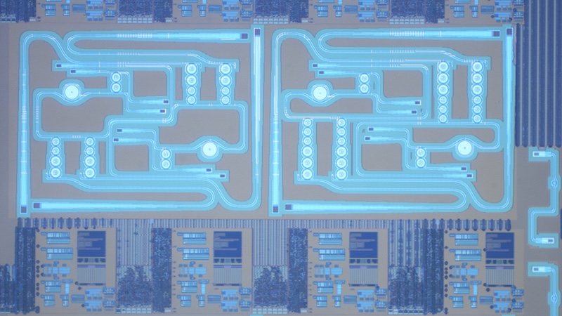

While quantum photonics promises faster and more stable qubits, integrating photonic components with classical control electronics on a single chip has been a longstanding challenge. Now, a collaboration between Northwestern University, Boston University, and UC Berkeley has demonstrated the first monolithic electronic-photonic quantum chip fabricated in a commercial foundry, marking a leap toward scalable quantum processors.
The team built a 1-mm x 1-mm silicon chip that combines microring resonators with integrated electronics for real-time stabilization. On-chip photocurrent sensors monitor the quantum light source, while microheaters adjust for temperature drift and fabrication imperfections. This feedback loop allows the chip to self-correct without the bulky, lab-scale stabilization equipment typically needed in photonic experiments.
A close-up image of the chip
A close-up image of the chip. Because the chip uses built-in feedback to stabilize itself, it behaves predictably despite temperature changes and fabrication variations. Image used courtesy of Northwestern University
By using a standard CMOS-compatible platform, the researchers proved that quantum photonic systems can be manufactured in the same high-volume foundries that produce classical semiconductors. This compatibility is critical for scaling quantum hardware from prototypes to commercial products.
Applications include secure quantum communication, sensing, and eventually quantum information processing, where stable, high-rate photon generation is essential. The team’s next steps involve integrating larger arrays of microrings and multiplexers to expand the number of photonic qubits on a single chip. As Northwestern’s Prem Kumar stated, this achievement marks “a key step toward scalable quantum photonic systems” that can be mass-produced like conventional electronics.
