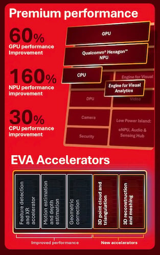

Features of the platform's architecture
Features of the platform's architecture. Image used courtesy of Qualcomm
A reworked Engine for Visual Analytics (EVA) block, hardened in silicon, offloads computer vision workloads, such as 3D environment reconstruction, from the main processing units. Qualcomm indicated that the expanded block could, from a chipset standpoint, support continuous scene meshing on headsets lacking a dedicated depth sensor, though it left specific implementations to developers. Moving those tasks to fixed-function hardware frees the GPU and NPU for rendering and AI inference, a trade that becomes more important as headsets attempt richer mixed-reality scenes without adding sensors or power budget.
