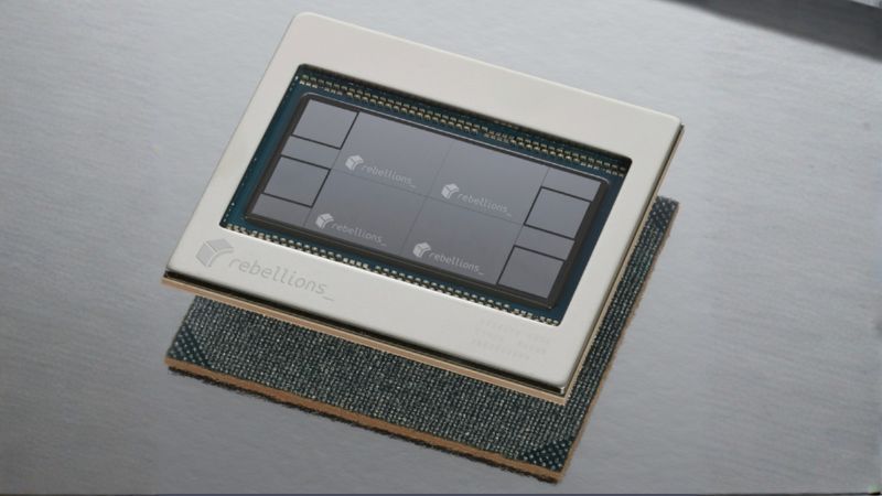

At Hot Chips 2025, Rebellions announced its newest AI accelerator, the Rebel-Quad. It delivers up to 2,048 teraflops on 8-bit Floating Point (FP8) computation with 50% lower power draw, making it a more energy-efficient alternative to leading GPUs.
Rebel-Quad
Rebel-Quad. Image (modified) used courtesy of Rebellions
