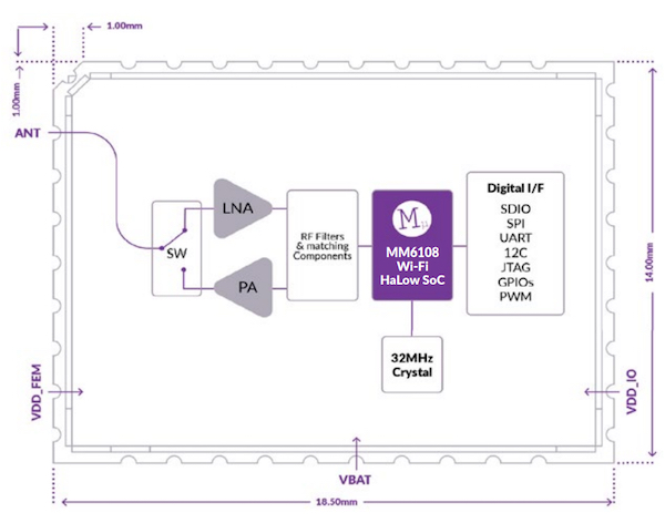

The SoC itself is packaged in an 18.5 mm x 14.5 mm package and is connected to RF filters and matching components, a 32-MHz crystal, and the digital I/F. The digital interface has a variety of serial and parallel interfaces for external communication. The RF front end has a low noise amplifier (LNA) and power amplifier (PA).
Block diagram of the MM6108 Wi-Fi HaLow module
Block diagram of the MM6108 Wi-Fi HaLow module. Image used courtesy of Morse Micro
Because the IEEE 802.11AH standard also enables extended sleep times, the MM6108 has a power management unit (PMU) for ultra-low-power operation. Morse Micro says the MM6108 is suitable for a wide variety of applications ranging from surveillance cameras to cloud connectivity and rural internet access.
