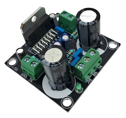

The 60 W Class-AB Audio Amplifier is a single-channel power amplifier board built around the STMicroelectronics TDA7296. This Class-AB amplifier is suited to a wide range of applications, including home stereo systems, self-powered speakers, and high-end televisions.
The TDA7296's high supply-voltage rejection enables a wide voltage range. Its high output current capability lets it deliver maximum power into both 4 and 8 Ω loads
A built-in muting function with a turn-on delay allows smooth remote operation and helps eliminate unwanted switching noise during power on/off. The mute and standby pins each require an external 5 V supply to operate. Screw terminals are provided for the speaker, power input, and audio input signal, and a 3-pin header brings out the standby and mute control voltages. Figure 1 shows the assembled board.
Figure 1. The assembled 60W Class-AB Audio Amplifier board, built
around the TDA7296.
Figure 1. The assembled 60 W Class-AB Audio Amplifier board, built around the TDA7296.

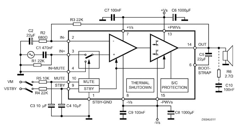

How It Works
The TDA7296 is a single-channel Class-AB audio power amplifier with a DMOS output stage. Audio enters through the inverting input (pin 2) via the 470 nF coupling capacitor C5, with R3 and R4 setting the closed-loop gain. The non-inverting input (pin 3) is referenced through the mute switch block, which is controlled by the MUTE and STBY pins (9 and 10). Both are driven from the CN3 header through R5 and R6, with C3 and C4 setting the turn-on/turn-off timing to suppress audible pops.
Bootstrap capacitor C9, connected between the BOOTSTRAP pin (6) and the output, lifts the drive voltage for the high-side DMOS device above the positive rail, letting the output swing to within a diode drop of +VS. The device runs from split ±35 V rails (+VS and −VS), bulk-filtered by C1 and C3 with C2 and C4 providing high-frequency bypassing.
Internal thermal shutdown and short-circuit protection circuitry guard the DMOS output stage without external components. Figure 2 shows the manufacturer's typical application and test circuit, which this board follows closely.
Figure 2. Typical application and test circuit for the TDA7296,
showing the mute/standby switching and protection blocks. Image used courtesy of
STMicroelectronics.
Figure 2. Typical application and test circuit for the TDA7296, showing the mute/standby switching and protection blocks. Image used courtesy of STMicroelectronics.

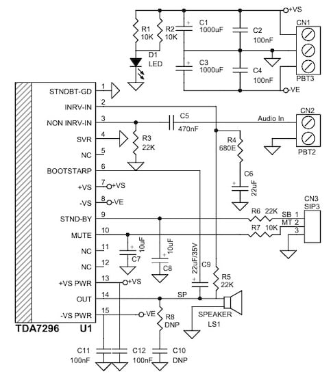

Schematic and Bill of Materials
The full schematic for the 60 W Class-AB Audio Amplifier is shown in Figure 3.
Figure 3. Schematic of the 60W Class-AB Audio Amplifier board.
Figure 3. Schematic of the 60 W Class-AB Audio Amplifier board.
The bill of materials is shown in Table 1.
Table 1. BOM for the 60 W Class-AB Audio Amplifier.
REF DESCRIPTION QTY MFG SUPPLIER PART NO.
CN1 3 Pin Screw Terminal, Pitch 5.08 mm 1 Phoenix Digikey 277-1248-ND
CN2 2 Pin Screw Terminal, Pitch 5.08 mm 1 Phoenix Digikey 277-1247-ND
CN3 3 Pin Male Header, Pitch 2.54 mm 1 Wurth Digikey 732-5316-ND
C1, C3 1000 uF / 50 V Electrolytic, 18 mm dia. 2 Nichicon Digikey 493-1623-ND
C2, C4, C11, C12 100 nF / 63 V Film Capacitor 4 Epcos Digikey 495-B32529C0104K006-ND
C5 470 nF / 63 V Film Capacitor 1 Epcos Digikey 495-2503-1-ND
C6 22 uF / 50 V Electrolytic, 6 mm 1 Nichicon Digikey
C7, C8 10 uF / 63 V Electrolytic, 6 mm 2 Nichicon Digikey
C9 22 uF / 50 V Electrolytic, 6 mm 1 Nichicon Digikey
R8, C10 DNP 2
D1 LED, Green, 3 mm 1 Wurth Digikey 732-5008-ND
LS1 2 Pin Screw Terminal, Pitch 5.08 mm 1 Phoenix Digikey 277-1247-ND
R1, R2, R7 10 K, 1/4 W, 5%, THT 3 Yageo/Stakpole Digikey
R3, R5, R6 22 K, 1/4 W, 5%, THT 3 Yageo/Stakpole Digikey
R4 680 Ohm, 1/4 W, 5%, THT 1 Yageo/Stakpole Digikey
U1 TDA7296, TO-220 1 ST Digikey 497-3966-5-ND

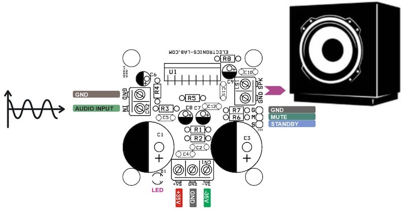

Connections
Figure 4 shows how power, audio, and the speaker connect to the board.
Figure 4. Connection diagram for the 60W Class-AB Audio Amplifier
board.
Figure 4. Connection diagram for the 60 W Class-AB Audio Amplifier board.
CN1 — Power Input (3-pin, 5.08 mm pitch):
  • Pin 1 = +VS, 35 V
  • Pin 2 = GND
  • Pin 3 = −VS, 35 V
CN2 — Audio Input (2-pin, 5.08 mm pitch):
  • Pin 1 = Audio Input
  • Pin 2 = GND
CN3 — Standby / Mute Control (3-pin header, 2.54 mm pitch):
  • Pin 1 = Standby
  • Pin 2 = Mute
  • Pin 3 = GND
LS1 — Speaker Output (2-pin, 5.08 mm pitch):
  • Pin 1 = Speaker
  • Pin 2 = Speaker
D1 — Power LED:
  • Illuminates when supply voltage is present

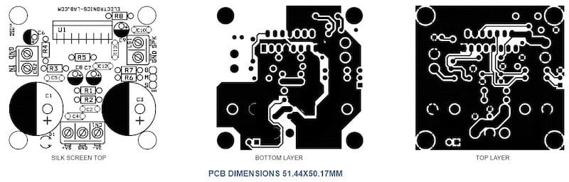

PCB Files
The PCB measures 51.44 mm x 50.17 mm. The silk screen, top layer, and bottom layer are shown in Figure 5.
Figure 5. PCB layout for the 60W Class-AB Audio Amplifier, showing
silk screen, top layer, and bottom layer.
Figure 5. PCB layout for the 60 W Class-AB Audio Amplifier, showing silk screen, top layer, and bottom layer.
