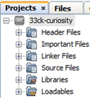

In the MPLAB X IDE environment, the project structure is visible on the Projects tab. In VS Code, it can be found on the Explorer tab.
MPLAB X IDE environment Projects tab
