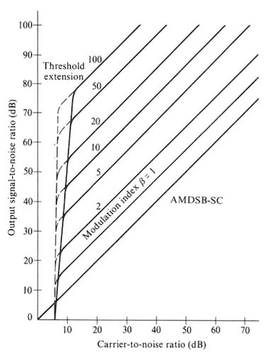

For a given message signal and deviation ratio D, all terms on the right-hand side remain constant except for the CNR ⍴, which depends on the carrier amplitude and noise power. In this case, one might expect the output SNR to vary linearly with ⍴. However, this linear relationship breaks down in practice as ⍴ approaches a threshold value.
Figure 1 below shows the output SNR versus ⍴ for a typical FM system across multiple modulation index values. As the CNR decreases from high to low values, the output SNR initially decreases linearly but then drops sharply beyond a certain point. This critical CNR value is known as the threshold.
Figure 1. Output SNR versus the CNR for a typical FM system. Image
used courtesy of Jerry D. Gibson.
Figure 1. Output SNR versus the CNR for a typical FM system. Image used courtesy of Jerry D. Gibson.
When the system operates near the threshold value for a curve, even minor fluctuations in the received signal power can lead to significant changes in the system’s SNR. This means that near the threshold CNR, one moment the signal is successfully received, and the next it’s obscured by the noise.
As observed, the threshold depends on the modulation index β, or more generally on the deviation ratio D. Higher values of β result in a higher threshold. A typical threshold value is approximately 10 dB.

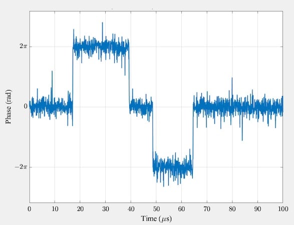

As observed, variations in the noise vector can cause point P1 to occasionally sweep around the origin, resulting in a phase increase or decrease of 2π radians. Figure 4, generated using MATLAB, illustrates how the phase of the resultant vector, ϕA(t), evolves when random noise is added to an unmodulated carrier.
Figure 4. Phase variation of the noisy FM signal at CNR = 3 dB.
Under low CNR conditions, the phase of the resultant vector exhibits abrupt transitions of ±2π radians, corresponding to the threshold effect described earlier. Between these jumps, the phase fluctuates continuously due to the underlying band-limited noise. The resulting waveform includes small-scale fluctuations and occasional large discontinuities.

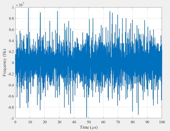

Since the demodulator produces the time derivative of the input phase, we expect the phase step changes of ±2π radians to generate sharp, impulse-like variations at the output. The derivative of the above waveform is shown in Figure 5.
Figure 5. Instantaneous frequency extracted from the phase waveform in
Figure 4.
Figure 5. Instantaneous frequency extracted from the phase waveform in Figure 4.
The waveform contains many impulse-like variations of varying magnitudes. Most of these impulses arise from small-scale fluctuations in the resultant vector’s phase ϕA(t) rather than from abrupt ±2π transitions.
In its current form, the instantaneous frequency waveform is difficult to relate directly to the phase signal. By applying a lowpass filter to suppress high-frequency noise, we obtain a smoothed waveform that more clearly reflects the underlying phase behavior. This step is justified by the fact that practical FM demodulators incorporate a lowpass filter at the output to limit the noise bandwidth to that of the message signal. The lowpass filter used in my simulations has a bandwidth of 500 kHz, which appears to be higher than what is typically employed in practical FM demodulators.

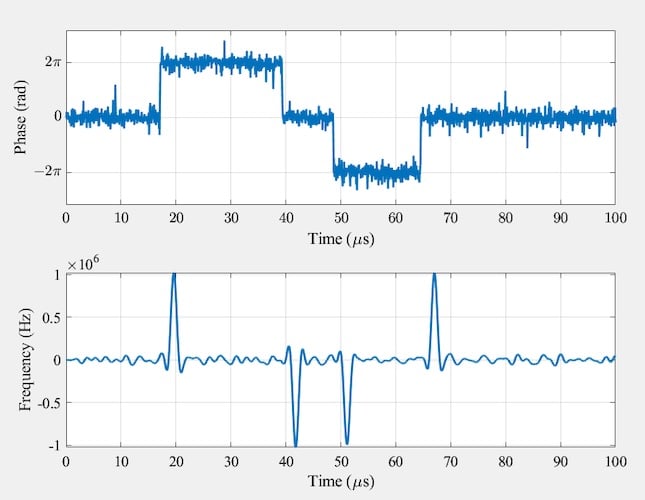

The lower curve in Figure 6 shows the filtered instantaneous frequency. The upper curve reproduces the phase waveform to facilitate comparison between the two.
Figure 6. Resultant vector’s phase (top) and lowpass-filtered
instantaneous frequency (bottom) at CNR = 3 dB.
Figure 6. Resultant vector’s phase (top) and lowpass-filtered instantaneous frequency (bottom) at CNR = 3 dB.
We observe that abrupt phase deviations of ±2π radians at the input produce sharp, impulse-like variations at the output. From linear systems theory, it follows that the areas of these impulses are nearly equal to ±2π radians.

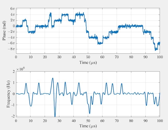

These spikes would manifest on an FM radio as a crackling or clicking noise. When the CNR is gradually reduced, the receiver initially produces occasional clicks. As the CNR drops further, the average number of clicks per unit time increases.
When this number becomes appreciably large, the threshold effect is said to occur. At this point, the clicks merge into a crackling sound and obscure the signal. Figure 7 shows the results for a lower CNR value of 0 dB, confirming an increase in the average number of impulses.
Figure 7. Resultant vector’s phase (top) and lowpass-filtered
instantaneous frequency (bottom) at CNR = 0 dB.
Figure 7. Resultant vector’s phase (top) and lowpass-filtered instantaneous frequency (bottom) at CNR = 0 dB.
The occurrence of spikes in the output suggests that the output noise spectrum is no longer parabolic. The spikes generate notable low-frequency content. In the presence of the threshold effect, the output SNR degrades abruptly and no longer follows the prediction of the standard formula (Equation 1).
