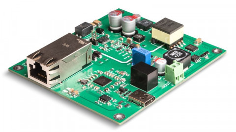

Comparing Inductive SMT Components – the Wire Makes the Difference!
Learn the differences between three inductive SMT components: ceramic inductors (air coils), SMT ferrites, and wire-wound ferrite inductors. This comparison includes electrical parameters, optimal applications, and the beneficial use of parasitic parameters.
Different designs of seemingly similar inductive SMT components can yield varying performance results. This whitepaper provides a clear comparison of three types of inductive SMT components: ceramic inductors (air coils), SMT ferrites, and wire-wound ferrite inductors. It details the differences in electrical parameters and explains their impact on performance.
While parasitic parameters are often seen as problematic, the note demonstrates how these characteristics can be leveraged for optimal circuit design.
Key topics include a comparison of the electrical parameters of WE-CBF, WE-KI, and WE-RFI components, an analysis of magnetic core materials and their effects on impedance, practical application examples, measurement techniques, and hardware setup.
