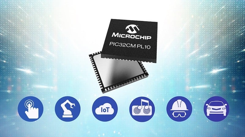

But what if there was a way to have two different voltage domains in the microcontroller at the same time? This is a scenario where the Multi-Voltage I/O (MVIO) peripheral becomes quite useful. For instance, imagine an industrial controller where the UART to/from the outside world is 5 V, but the logic inside the assembly is 3.3 V. A 5 V MCU can’t interface with the 3.3V devices since the I/O would be 5 V referenced.
MVIO is a hardware peripheral that enables an MCU to have an I/O bank supplied independently from the core. So, in the above example, the MVIO bank could be powered at 5 V, while the rest of the MCU runs at 3.3 V. All the required I/O level translation occurs in the I/O pads of the MCU with no extra area, costs or hassles.
Microchip’s PIC32CM-PL10 microcontroller.
Figure 4. Microchip’s PIC32CM-PL10 microcontroller
MVIO also can work in reverse, such as a 5 V MCU with a dedicated 3.3 V (or lower) I/O bank. MVIO was first introduced on the AVR DB family of MCUs but is now available on 32-bit products such as the Microchip PIC32CM-PL10 MCUs (Figure 4). The PL10 is a 1.8 V to 5.5 V MCU containing an Arm Cortex-M0+ CPU at 24 MHz with a built-in water-resistant capacitive touch controller.
The PL10 family of MCUs is pin-to-pin compatible with the AVR Dx [for example, DA, DB, DD] families of MCUs for an easy upgrade path, and this combination of features allows PL10 MCUs to be used in a wide variety of applications and operating ranges.
