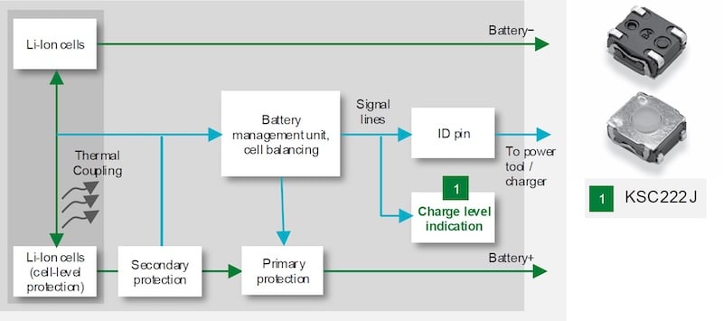

Tactile Switch Offering Precision, Protection, and Longevity
After extensive testing and consultation, the team selected a sealed surface-mount tactile switch that met all their requirements: the Littelfuse KSC2 series. This switch delivered the right combination of ruggedness, compactness, and electrical performance to meet all application requirements.
Tactile switch charge level indicator
Figure 2. Tactile switch charge level indicator
Here's are the engineers’ analysis of how the selected tactile switch met each of the design challenges:

Seamless Circuit Integration
The momentary electrical connection provided by the selected tactile switch easily interfaces with the tool's battery management system (BMS). This approach enables the BMS to interpret the button press as a trigger to wake up and display battery capacity, without affecting power regulation or interfering with the main control loop.
The sealed switch also complements circuit protection strategies, since its robust housing helps isolate the control circuit from moisture or conductive particles that could cause shorts or component failure.
