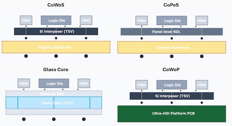

Today, multi-die AI accelerators with HBM are built primarily on chip-on-wafer-on-substrate (CoWoS). A silicon interposer is fabricated on a 300 mm wafer using conventional front-end and back-end processes. This interposer provides dense redistribution layers (RDL) for thousands of fine-pitch connections between a logic die and multiple HBM stacks, as well as through-silicon vias (TSVs) to carry power and signals down to an organic substrate.
The flow is familiar: dies are placed and bonded on the interposer wafer, the wafer is diced into large rectangular interposers, and the waste area at the circular edge is discarded. The die-interposer assemblies are then mounted on a high-performance organic substrate—commonly based on Ajinomoto Build-up Film (ABF)—which serves as a coarse redistribution layer and provides the solder bumps that connect to the PCB: a heat spreader and cooling solution on top complete the stack.
This architecture naturally creates three classes of interconnect:
  • Very fast and dense on-die wiring.
  • Somewhat slower and less dense interconnect on the silicon interposer
  • Relatively slow and sparse routing in the organic substrate and PCB.
It is up to the system architect to juggle these domains—partitioning functions across dies and deciding which signals stay on-die, cross the interposer, or traverse the substrate—to meet bandwidth, latency, and power targets.

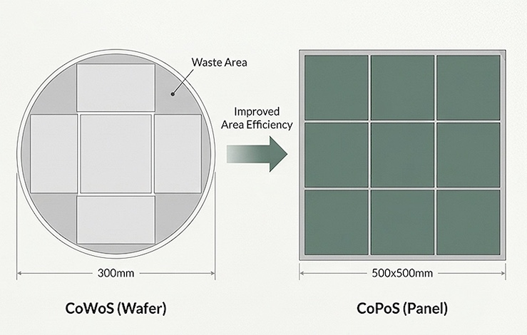

The second constraint is geometry. We are cutting large rectangular shapes from a circular wafer. Even with careful die tiling, a significant fraction of the wafer edge area cannot be used as usable interposers. In practice, only about two-thirds of the theoretical wafer area converts into large, high-quality interposer dies.
The result is a technology that is functionally excellent but capital-intensive and capacity-constrained. Foundries have invested heavily to increase CoWoS output, but demand from AI accelerators and other multi-die systems continues to catch up. For many programs, the question is not whether CoWoS is technically suitable, but whether it will be available in the right volume, at an acceptable cost, and on a satisfactory schedule.
CoPoS: Another Path
One proposed successor is chip-on-panel-on-substrate (CoPoS), a panel-level fan-out packaging technology. Conceptually, CoPoS extends the CoWoS idea to a rectangular panel rather than a round wafer. Panel sizes on current roadmaps range from roughly 300 × 300 mm to around 500 × 500 mm, depending on the supplier and process. (Figure 1).
From a system perspective, the main advantage is area utilization. Large rectangular devices tile naturally on a rectangular panel, with far less dead area than on a circular wafer. For ultra-large AI packages that approach the limits of CoWoS-S, this extra usable area directly translates into more packages per carrier and a lower cost per square millimeter of “useful” interposer or fan-out region.
Comparing the area utilization of CoWoS and CoPos.
Figure 1. Comparing the area utilization of CoWoS and CoPos
Panel-based processes on organic or glass carriers have already demonstrated redistribution layers with line/space in the 3–5 µm range, with development work pushing toward finer geometries. This is not yet as aggressive as the most aggressive silicon-interposer wiring. Still, it is sufficient for many HBM-on-logic topologies if bump pitch and interface width are chosen carefully.
The trade-off is maturity. CoPoS requires new tools, new materials handling, and new yield learning. Public roadmaps and industry reports describe pilot lines in the middle of this decade and mass production closer to the end of the decade. That makes CoPoS a medium-term option: attractive for designs that need vast fan-out areas and can align their launch windows with that schedule, but not yet a drop-in replacement for near-term, high-risk flagship products.

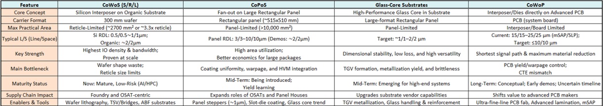

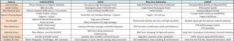

In parallel, the substrate industry is working on glass-core panel substrates. Compared with organic cores, glass offers several attractive properties:
  • Superior dimensional stability and lower warpage, which help alignment and yield on large panels.
  • Low dielectric loss, significant for multi-gigabit and multi-tens-of-gigabit links.
  • The potential for fine-pitch RDL on both sides of the core, plus through-glass vias (TGVs) to connect them.
Equipment and materials vendors have reported roadmaps for glass substrates with line/space moving into the low-micron range, along with panel sizes similar to those discussed for panel-level fan-out. In effect, glass cores can bring some “interposer-like” routing density into the substrate itself. (Figure 3.)
Table comparing the use of  glass core in the substrate withalternative materials. (Click on image to enlarge).
Figure 2. Table comparing the use of glass core in the substrate with alternative materials. (Click on image to enlarge).
For system and chip designers, glass opens several scenarios:
  • Reducing or eliminating the need for a separate silicon interposer in some 2.5D assemblies by shifting more routing into the glass core.
  • Combining panel-level fan-out on top of a glass core to build very large AI or networking packages without pushing CoWoS-S beyond its comfortable range.
  • Enabling low-loss, high-frequency paths for chiplets, SerDes, or RF functions at the package level.
Glass is not a free upgrade. It demands different forms of formation, other handling and reinforcement, and new inspection strategies. Existing organic-core lines are well amortized and will remain attractive for many products. In practice, glass is likely to appear first in the highest-end, most bandwidth-hungry systems and then gradually diffuse into broader markets as volumes grow and costs fall.

Chip-on-wafer-on-Platform-PCB (CoWoP) is the most disruptive of the four options. Here, instead of mounting the silicon interposer or fan-out assembly on an organic package substrate, the entire structure is attached directly to a high-density printed-circuit board. (Figure 3.) The ABF or BT substrate disappears from the stack.
Chip-on-Wafer-on- Platform-PCB (CoWoP).
Figure 3. Chip-on-Wafer-on- Platform-PCB (CoWoP)
To make this feasible, the PCB must become much more like a substrate. Ultra-HDI boards with line/space in the 15–20 µm range, multiple lamination cycles, and carefully engineered materials to control warpage and CTE are required. This is a significant stretch from today’s mainstream server boards, but not out of reach as PCB technology advances.

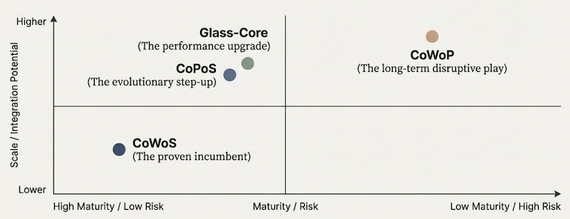

If CoWoP can achieve stable yields on large interposers or fan-out assemblies mounted directly onto boards, it offers a simple story: fewer layers, fewer assembly steps, and a shorter path from silicon to system. It would also shift more value and innovation to PCB manufacturers, potentially changing the structure of the advanced-packaging supply chain.
The risk is that CoWoP compresses several challenging problems—fine-line PCB manufacturing, flatness on large boards, high-current power delivery, and advanced inspection—into a single, tightly stacked solution. Today, it remains closer to concept and early demo than to high-volume production. Designers should treat it as a long-term option rather than an immediate replacement for CoWoS or CoPoS (Figure 4.)
CoWoP may be the leading technology for advanced packaging in thefuture. For now, it presents a high risk and little maturity for today’spackaging designers.
Figure 4. CoWoP may be the leading technology for advanced packaging in the future. For now, it presents a high risk and little maturity for today’s packaging designers.
Choosing Paths, Not a Single Winner
Given these diverging options, it is tempting to ask which one will “win.” A more realistic view is that all four will coexist, each serving different parts of the market:
  1. CoWoS remains the default for flagship AI accelerators and high-end networking ASICs whenever schedule and technical risk must be minimized.
  2. CoPoS becomes attractive for ultra-large, high-bandwidth packages when panel-level flows are proven in production and capacity is in place.
  3. Glass-core panels act as an upgrade path for substrates, either complementing or partially replacing silicon interposers in select applications.
  4. CoWoP may eventually provide a simplified, cost-efficient path for volume systems once ultra-HDI PCB manufacturing and inspection are mature.
