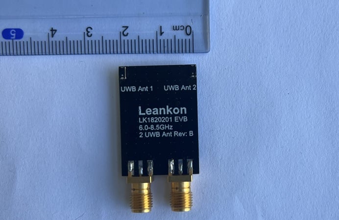

Let's look at an example. The test setup we'll use is illustrated in Figure 1.
Two Leankon UWB antennas to demonstrate decoupling.
Figure 1. Two Leankon UWB antennas to demonstrate decoupling.
This device uses two Leankon LK1820201 SMD UWB antennas. The PCB dimensions are 30 mm × 21.2 mm × 1 mm.
As noted earlier, Qorvo recommends a distance of 0.45λ between two UWB antennas for AOA applications. For UWB Channel 9 (center frequency = 7.987.2 MHz, BW = 499.2 MHz), 0.45λ translates to approximately 16.87 mm. We're using UWB Channel 9 for this example, so the two antennas in Figure 1 are separated by 16.87 mm.

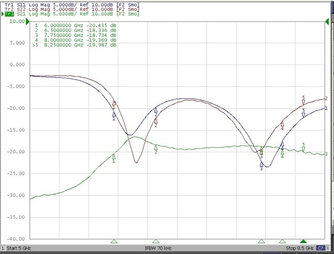

Figure 2 measures the isolation of the two antennas without any decoupling elements. It also shows the antennas' return loss (S11), a key indicator of antenna impedance matching.
Return loss and isolation of two UWB antennas without decoupling element.
Figure 2. Return loss and isolation of two UWB antennas without decoupling element.

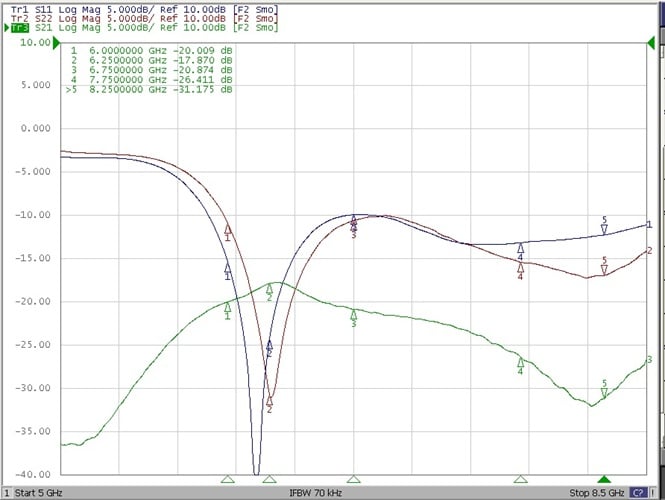

Figure 3 shows the results of integrating a decoupling element between the two UWB antennas.
Return loss and isolation of two UWB antennas with a decoupling element.
Figure 3. Return loss and isolation of two UWB antennas with a decoupling element.
Comparing Figures 2 and 3, we can see that the isolation has significantly improved. The optimized design achieves an isolation of less than –26 dB across the entire frequency band of UWB Channel 9, surpassing Qorvo's recommended minimum isolation threshold of –25 dB.
This consistent performance across the full operating range ensures that mutual interference between the two AOA antennas is effectively suppressed, laying a solid foundation for high-precision UWB positioning.
