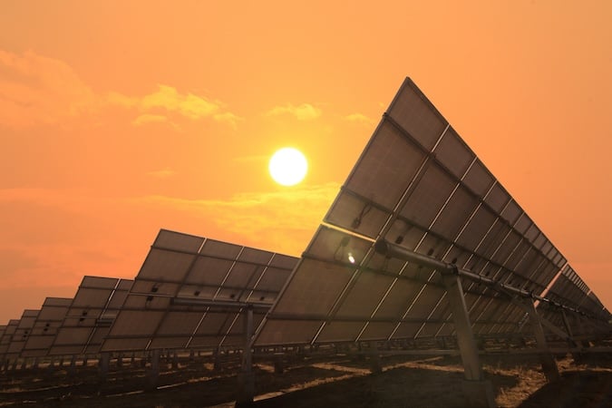

Smart micro inverters
Smart micro inverters are set to optimize solar energy systems in the near future. Image used courtesy of Hoymiles

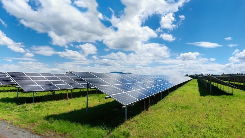

clouds shading the solar panels
Cloud shading is one cause of inconsistent solar panel performance. Image used courtesy of Adobe Stock
The Barrel Effect arises from inconsistencies in the output characteristics of PV panels, as panels from the same manufacturing batch tend to have variations in manufacturing tolerances. Over time, factors like uneven soiling, partial shading from nearby objects like trees and buildings, or aging can further widen the disparities in panel performance.

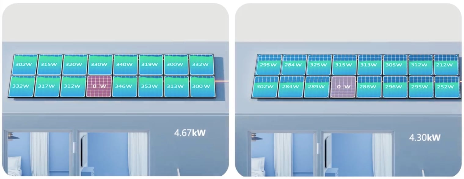

Microinverters overcome string inverters' safety and performance challenges through their parallel design. Rather than connecting the panels in series, microinverters allow each panel to operate independently, with its own inverter converting DC into AC at the module level. This distributed architecture eliminates the need for high-voltage DC connections between panels.
a microinverter system (left) and traditional string inverter single (right)
When a single panel fails or underperforms, a microinverter system (left) provides 4.67 kW power compared to only 4.30 kW for a traditional string inverter single (right). Image used courtesy of Hoymiles
Unlike string inverters, microinverter systems typically operate at DC voltages below 60 V, which falls within the low voltage category. The lower-voltage operation reduces the risk of fire during installation and maintenance, as the energy available for arc faults is much lower. Even if a fault occurs, the low voltage makes the system touch-safe.

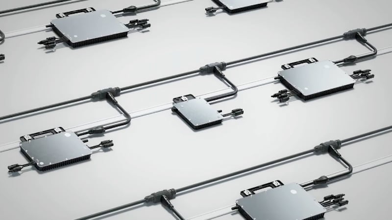

Hoymiles HMS-1000 series 2-in-1 microinverters are designed for high-powered panels and can connect two PV modules. The four products in the family support 700, 800, 900, and 1000 VA of peak output power. The HMS-2000 series 4-in-1 microinverters support four panels with peak output powers of 1600 to 2000 VA.
Hoymiles series microinverters
Hoymiles series microinverters can connect up to 4 panels. Image used courtesy of Hoymiles
These products achieve CEC peak efficiencies of 96.7%, minimizing conversion losses and maximizing energy harvest. Their wide MPPT voltage range of 16 to 60 V enables reliable operation across a range of environmental conditions and panel configurations.
