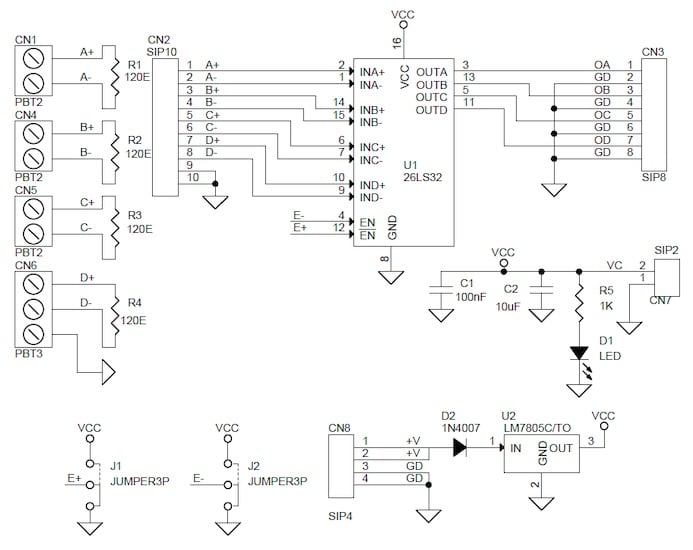

Power conditioning is handled by the LM7805 linear regulator, which accepts the 7 V to 18 V supply on CN8 and delivers a regulated 5 V rail. D2 (1N4007) provides reverse-polarity protection. Decoupling capacitors C1 (100 nF) and C2 (10 µF) suppress high-frequency and low-frequency noise on the 5 V rail. The power LED (D1) with series resistor R5 (1 kΩ) gives a visual indication that 5 V is present.

Figure 3 shows the schematic for the four-channel RS-422 differential line receiver module.
Figure 3. AM26LS32 quadruple differential line receiver module
schematic.
Figure 3. AM26LS32 quadruple differential line receiver module schematic.

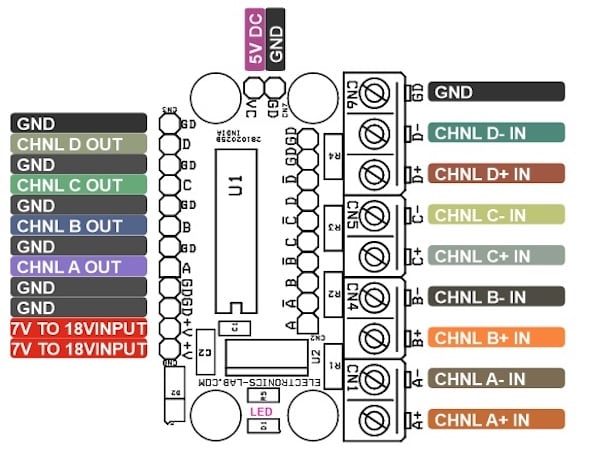

The connection diagram in Figure 4 shows all input and output assignments.
Figure 4. AM26LS32 module connection diagram.
CN1 — Channel A Differential Input (2-pin screw terminal, 5.08 mm pitch):
  • Pin 1 = Channel A+ Input
  • Pin 2 = Channel A− Input
CN4 — Channel B Differential Input (2-pin screw terminal, 5.08 mm pitch):
  • Pin 1 = Channel B+ Input
  • Pin 2 = Channel B− Input
CN5 — Channel C Differential Input (2-pin screw terminal, 5.08 mm pitch):
  • Pin 1 = Channel C+ Input
  • Pin 2 = Channel C− Input
CN6 — Channel D Differential Input (3-pin screw terminal, 5.08 mm pitch):
  • Pin 1 = Channel D+ Input
  • Pin 2 = Channel D− Input
  • Pin 3 = GND
CN2 — SIP-10 Header (optional — Do Not Install):
  • Not populated in standard configuration
CN3 — Output Header (8-pin male, 2.54 mm pitch):
  • Pin 1 = Output A
  • Pin 2 = GND
  • Pin 3 = Output B
  • Pin 4 = GND
  • Pin 5 = Output C
  • Pin 6 = GND
  • Pin 7 = Output D
  • Pin 8 = GND
CN7 — 5 V Power Tap (2-pin male header, 2.54 mm pitch):
  • Pin 1 = GND
  • Pin 2 = 5 V DC
CN8 — Power Input (4-pin male header, 2.54 mm pitch):
  • Pins 1, 2 = 7 V to 18 V DC Input
  • Pins 3, 4 = GND
J1, J2 — Enable Solder Jumpers (under PCB):
  • J1 = Active-low enable (EN−)
  • J2 = Active-high enable (EN+)
D1 — Power LED:
  • Illuminates when 5 V is present on the board

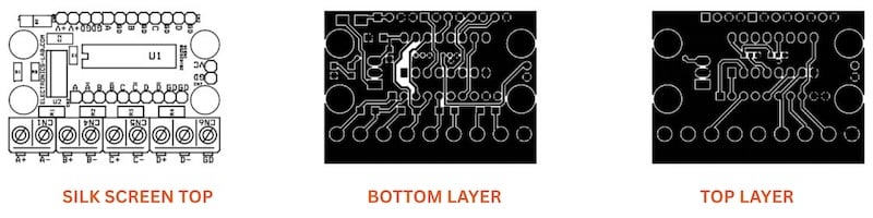

PCB Files
Figure 5. PCB layout: top silk screen, bottom copper layer , top
copper layer.
Figure 5. PCB layout: top silk screen, bottom copper layer, top copper layer.
