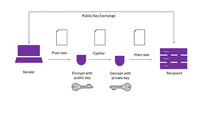

The Role of PKI
PKI works hand-in-hand with a chain of certificates signed using private keys that connect to a known, trusted certificate authority and which can be checked using the corresponding public keys. Any endpoint that interacts with the device can use standard protocols to check that digital certificates stored on a device are legitimate (Figure 1). That is, they are owned by a known provider and an adversary has not been able to tamper with them.
Checking the provenance of certificates and other credentials relies on an interlocking set of cryptographic keys and hardware-security resources within the device. Those hardware resources are implemented as a root-of-trust built into the core computing elements of each IoT device.
PKI is used to check that digital certificates stored on a device are legitimate and have not been tampered with.
Figure 1. PKI is used to check that digital certificates stored on a device are legitimate and have not been tampered with.
