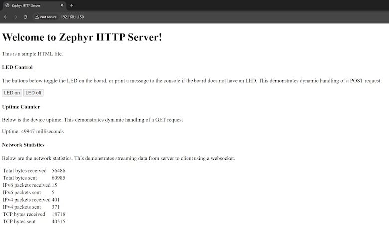

While the official setup instructions for Zephyr cover getting started with the blinky sample, I wanted my first “real” Zephyr application to be something non-trivial. For this, I chose the HTTP Server Sample (samples/net/sockets/http_server). The default webpage the microcontroller serves also allows the connected device to get real time statistics and to blink an LED on the board. I built the sample for the SAM E54 Xplained Pro evaluation kit and it worked almost immediately, barring some minor networking adjustments for my setup.

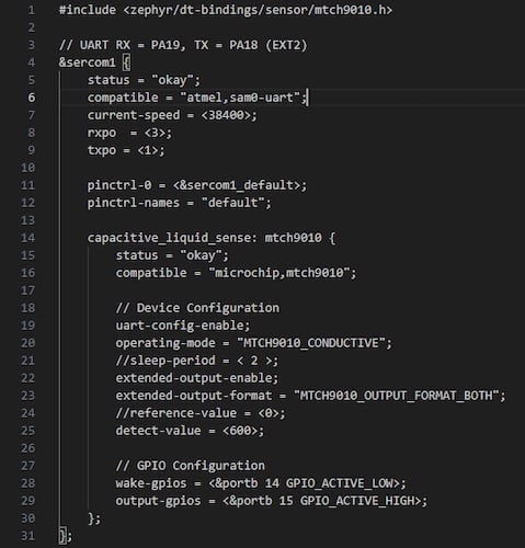

Devicetree is a YAML-based language for defining how hardware is connected. Devicetree defines the System on Chip (SoC), hardware peripherals, the development board and connected shields or utilized I/O. Zephyr uses different file extensions to denote the different layers of Devicetree and then flattens them at compile time. Consider this top-level overlay file (*.overlay) from my MTCH9010 test project:
Figure 2. Devicetree snippet from my MTCH9010 test project for the SAML21 XPLAINED PRO (ATSAML21-XPRO-B).
Figure 2. Devicetree snippet from my MTCH9010 test project for the SAM L21 XPLAINED PRO (ATSAML21-XPRO-B).
This snippet does the following: enable SERCOM1, use the “atmel, sam0-uart” driver, set SERCOM1 to a baud rate of 38400 and set the location of RX and TX signals for the I/O. Then, the MTCH9010 driver is nested inside the definition to specify that it uses this SERCOM for communication. The parameters for operating mode, detect value and etc. are all parameters that specify how to configure this instance of the sensor.

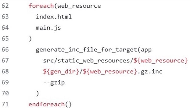

If large files are included like this, any changes made later will require a non-trivial amount of effort. In addition, there is no data compression to optimize memory usage or network bandwidth. Adding compression would make it both difficult to write and practically unmaintainable in the long term. However, Zephyr uses a clever trick by using the pre-compiler script to convert each file into a gzip compressed include file (*.gz.inc) that can be included directly. A snippet from the CMake build script is shown below:
Figure 5. A snippet of CMakeLists.txt from the http_server sampleproject (Apache 2.
Figure 5. A snippet of CMakeLists.txt from the http_server sample project (Apache 2.0)

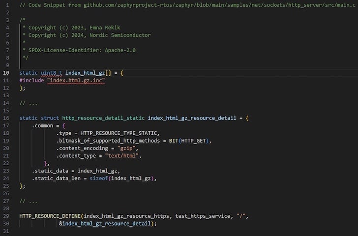

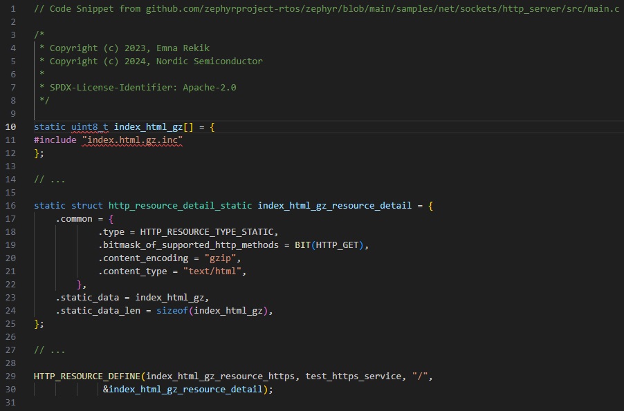

Since the compressed resource files are generated automatically, it is trivial to change the file. Next, in the project, the arrays are loaded by including the compressed file. Each file will also need a matching resource structure and an HTTP_RESOURCE_DEFINE to match. The snippet below shows these parts for the index page.
Figure 6. Code snippets from http_server/src/main.c .
Figure 6. Code snippets from http_server/src/main.c . (Click on image to enlarge)
And, just like that, a customized, fully operational web server is up and running, in less than an afternoon.
