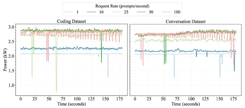

An accelerator does not draw constant power. Power demand changes based on workload types and task schedules. It also depends on hardware utilization and memory access. Power measurements show rapid variations even during steady workloads. For example, the power profiles in Figure 1 show rapid, workload-dependent variations in accelerator power demand.
Figure 1. Measured power profiles for a Llama-3 70B online inference
workload under sustained request rates.
Figure 1. Measured power profiles for a Llama-3 70B online inference workload under sustained request rates. Image used courtesy of the National Laboratory of the Rockies

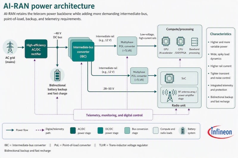

The traditional telecom power architecture is still very effective. AC grid power feeds a rectifier that powers a nominal -48 V DC bus. This bus distributes power efficiently and supports battery backup. It also powers downstream DC/DC converters. AI-RAN does not require replacing this standard backbone. However, it does require some enhancements (Figure 2).
Figure 2. AI-RAN power architecture. AI-generated image from
Infineon.
Figure 2. AI-RAN power architecture. AI-generated image from Infineon.
AI-RAN increases stress on every connected power stage. The AC/DC rectifier must stay efficient across a wider operating range. The intermediate-bus converter (IBC) must deliver power without overheating. Point-of-load (POL) converters must maintain stable voltages during fast current steps. The battery backup system must support higher and more variable loads without failing.
Real-time telemetry becomes essential. Operators should monitor rectifier loads, bus conditions, phase currents, battery status, and temperatures. A unified management layer displays this data. This allows engineers to fix electrical or thermal problems before outages occur.

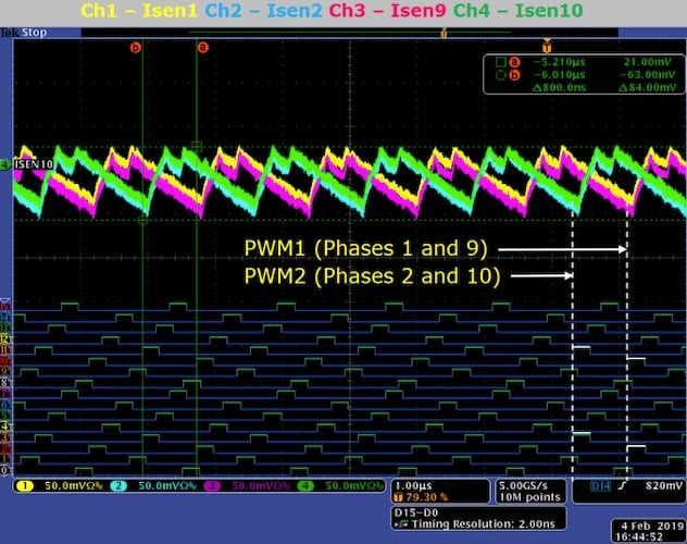

High-current delivery also depends on maintaining balanced phase currents during load changes. Infineon tests of a dual-phase design show closely matched phase currents during a 300 A load jump (Figure 3). This test does not simulate an explicit AI-RAN workload. However, it demonstrates the dynamic current sharing needed for modern processors.
Figure 3. Phase-current balance across paired power stages during a
300 A load step.
Figure 3. Phase-current balance across paired power stages during a 300 A load step. Image used courtesy of Infineon
