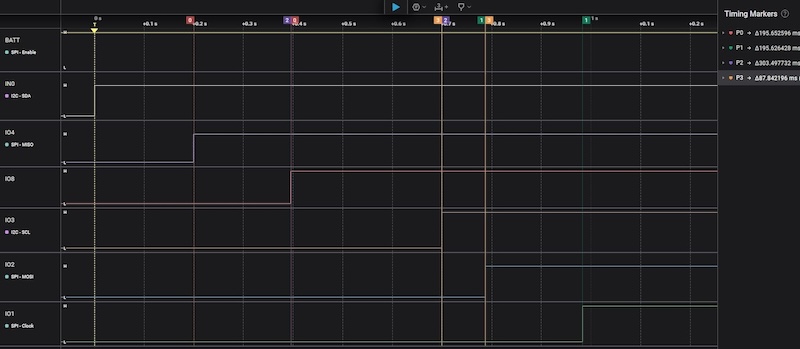

Let’s begin by looking at Figure 1. This is a power-sequencing example based on a single-battery input.
It will help us understand how PLDs can simplify your designs while offering more flexibility compared to discrete logic solutions. If the battery voltage is acceptable, the device will proceed through the sequence based on the timing shown in the figure.
Power-sequencing timing diagram for a single-battery system
Figure 1. Power-sequencing example based on single-battery input. [click to enlarge]

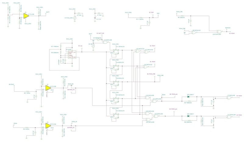

Figure 2 is the circuit schematic for a discrete logic design that would generate the signals of Figure 1.
Analog and discrete logic power-sequencing schematic
Figure 2. Analog and discrete logic power-sequencing schematic. [click to enlarge]
As you can see, supporting power sequencing through analog and discrete logic is easily accomplished. However, the number of devices and relative printed circuit board area are not optimal.
Inevitably, the discrete approach will lead to higher development costs and final product costs than a PLD-based design. Supporting analog and discrete logic also requires you to negotiate, procure, store, and place numerous discrete devices and their associated passives on the PCB.

The circuit in Figure 3 uses an input-enable signal fed into a counter. The control data of the counter block, combined with the clock from the internal oscillator, sets the delay between each sequence signal. Since the counter reset triggers on the rising and falling edge of the enable signal, the device does not signal to begin power down until the input enable signal falls.
What if we wanted to change the timing of the power-sequencing controller? Using a discrete resistor-capacitor network would require new RC values and a change to our bill of materials. With a PLD design, we could simply reconfigure the internal oscillator and associated dividers without needing to modify the bill of materials.

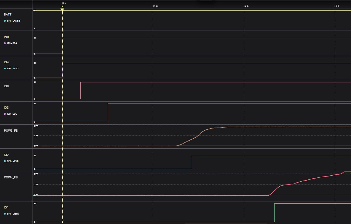

Because the example application relies on a battery for its power source, the voltage can vary based on the state of the battery. Building on the previous example, you can use the additional logic functions to add another power-sequencing use case.
In Figure 4, the TPLD1202 is looking for a voltage or voltage range on POWER3 feedback before enabling POWER3. Then, it moves on to the POWER4 feedback to check its requirements against the battery voltage (Figure 4). Only after meeting these voltage requirements will the product fully power up for operation.
Timing diagram for TPLD1202 power sequencing with voltage monitoring
Figure 4. TPLD1202 power sequencing with voltage monitoring. [click to enlarge]
For power-down sequences, you can ensure safe power-down by using the same parameters monitored during power-up in reverse.
