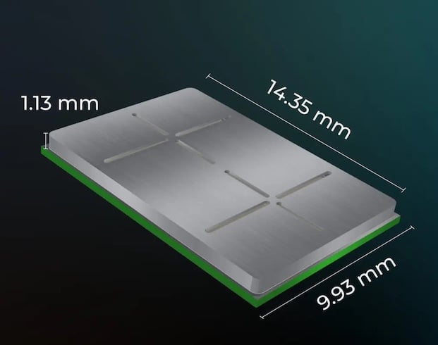

μCooling xMC-4800.
Figure 2. μCooling xMC-4800.
