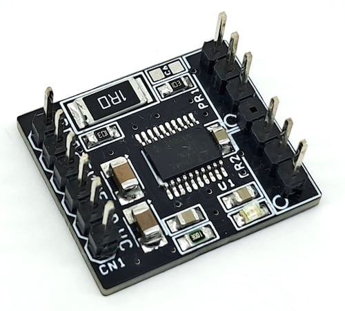

This 500mA Power Op Amp Breakout Board is designed around the Analog Devices LT1970A, a high-current operational amplifier. The board operates on a dual power supply and includes an onboard fault indicator LED for easy diagnostics, with header connectors for power input, signal input, and output that make integration into a larger design simple. Figure 1 shows the assembled board.
Figure 1. The assembled 500mA Power Op Amp Breakout Board, built
around the LT1970A.
Figure 1. The assembled 500mA Power Op Amp Breakout Board, built around the LT1970A.

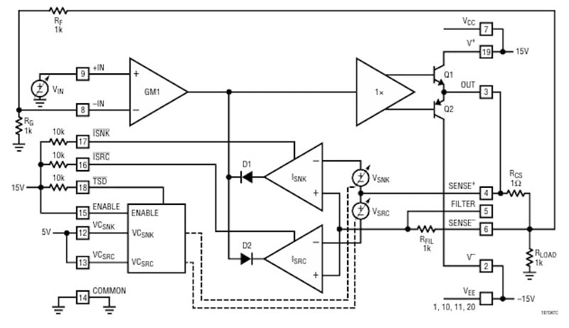

Figure 2 shows the manufacturer's block diagram and test circuit that this board implements. The LT1970A's output stage is protected by two independent current-limit loops. ISNK and ISRC compare the voltage across the current-sense resistor R2 (1 ohm) against the VCSNK and VCSRC control voltages brought in on the PR2 and PR1 headers. This clamps the output drive whenever either threshold is exceeded.
Figure 2. Block diagram and test circuit for the LT1970A, showing the
independent source and sink current-limit loops.
Figure 2. Block diagram and test circuit for the LT1970A, showing the independent source and sink current-limit loops. Image used courtesy of Analog Devices
Because these thresholds are set by external voltages rather than fixed internally, the sourcing and sinking limits can be programmed independently and adjusted in-circuit, with 1% accuracy from the resistor-set thresholds R3 and R4.
Open-collector flags TSD, ISNK, and ISRC report thermal shutdown and current-limit activation back to the host system, while the ENABLE pin puts the amplifier into a low-power, high-impedance output state when pulled low. On this breakout board, D1 (through current-limiting resistor R1) serves as a fault indicator, and C1 through C5 provide local supply bypassing for the ±VCC/VEE rails.

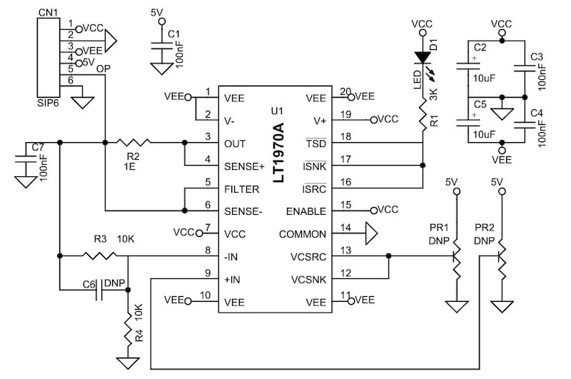

Schematic and Bill of Materials
The full schematic for the 500mA Power Op Amp Breakout Board is shown in Figure 3.
Figure 3. Schematic of the 500mA Power Op Amp Breakout Board.

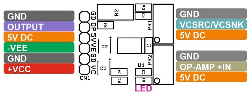

Connections
Figure 4 shows how power, signal, and output connect to the board. Note that PR1 and PR2 are DNP (do not populate) on the stock assembly.
Figure 4. Connection diagram for the 500mA Power Op Amp Breakout
Board.
Figure 4. Connection diagram for the 500mA Power Op Amp Breakout Board.
CN1 — Power and Signal (6-pin header, 2.54 mm pitch):
  • Pin 1 = +VCC
  • Pin 2 = GND
  • Pin 3 = −VEE
  • Pin 4 = 5 V DC
  • Pin 5 = Output
  • Pin 6 = GND
PR1 — Sink/Source Current-Limit Set (DNP):
  • Pin 1 = 5 V DC
  • Pin 2 = VCSRC / VCSNK
  • Pin 3 = GND
PR2 — Op-Amp Input Set (DNP):
  • Pin 1 = 5 V DC
  • Pin 2 = Op-Amp +IN
  • Pin 3 = GND
D1 — Fault LED:
  • Indicates current-limit or thermal shutdown activation

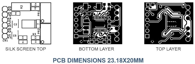

PCB Files
The PCB measures 23.18 mm x 20 mm. The silk screen, top layer, and bottom layer are shown in Figure 5.
Figure 5. PCB layout for the 500mA Power Op Amp Breakout Board,
showing silk screen, top layer, and bottom layer.
Figure 5. PCB layout for the 500mA Power Op Amp Breakout Board, showing silk screen, top layer, and bottom layer.
