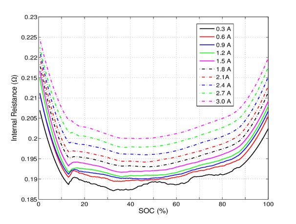

A well-behaved battery will exhibit a low IR to deliver the required power spikes on demand (and extended battery runtime). However, shifts in a battery’s IR can occur due to calendar and cyclic aging; temporary fluctuations in IR can also occur with ambient temperature changes and even SOC variations as shown in Figure 2.
The variation in IR different discharge currents and SOC levels of a Li-ion battery.
Figure 2. The variation in IR different discharge currents and SOC levels of a Li-ion battery. Image source: [1]

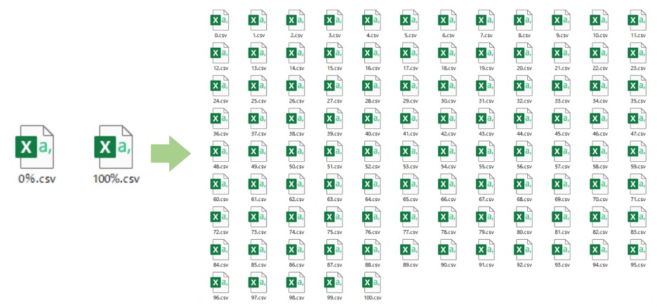

However, if data is only available for 0% and 100% SOC the auto interpolation function will automatically create data for all SOCs in between with a minimum resolution of 1% (Figure 8).
he auto-interpolation function will automatically fill data between 0% and 100% SOC so testing can begin as rapidly as possible.
Figure 8. The auto-interpolation function will automatically fill data between 0% and 100% SOC so testing can begin as rapidly as possible. Image source: Kikusui Electronics

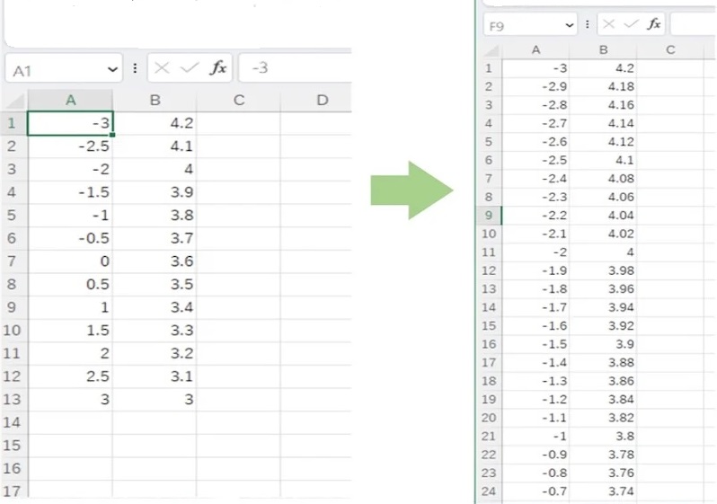

Even data within the original I-V file can be auto-interpolated (Figure 9) — a file with 13 points of data is expanded to 60 data points with a resolution of 0.1 A.
Data interpolation can also be performed within an I-V data file.
Figure 9. Data interpolation can also be performed within an I-V data file. Image source: Kikusui Electronics

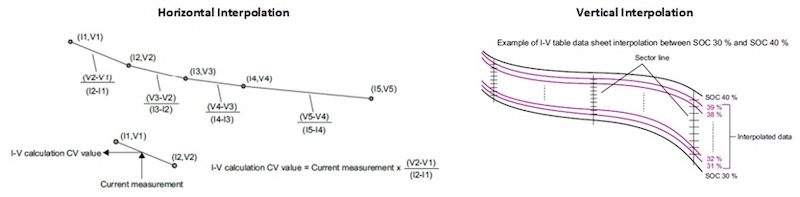

This ability simplifies the process of creating and expanding an exhaustive dataset for battery emulation to begin testing more rapidly. Kikusui uses both horizontal and vertical interpolation techniques. If the values within an established I-V file are further apart than 0.1 A, the battery emulator fills in the data between two points with linear interpolation (Figure 10). For vertical interpolation (refer to Figure 8), the battery emulator generates an interpolated I-V files at 1% increments with the requirement that data can only be generated when the current ranges of the upper and lower data match.
Horizontal and vertical interpolation processes used to fill in data with the battery emulator system.
Figure 10. Horizontal and vertical interpolation processes used to fill in data with the battery emulator system. Image source: Kikusui Electronics

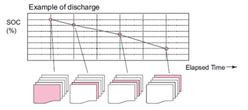

During operation, the SOC is calculated from the charge/discharge current and present nominal capacity of the battery. As shown in Figure 11, for SOCs that change with time (e.g., during discharge), the interpolated I-V file that corresponds to the SOC is selected and emulation is performed.
An example of a battery discharge performed by the emulator where interpolated I-V files are selected based upon the expected SOC over time.
Figure 11. An example of a battery discharge performed by the emulator where interpolated I-V files are selected based upon the expected SOC over time. Image source: Kikusui Electronics

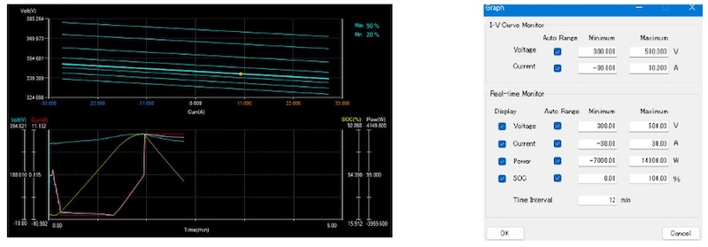

The user interface and display can be seen in Figure 12 with the interpolated I-V curve as well as the voltage, current, power, and SOC plotted over time.
Display (left) and user interface (right) where the real-time monitor will display voltage, current, power, and SOC data over time.
Figure 12. Display (left) and user interface (right) where the real-time monitor will display voltage, current, power, and SOC data over time. Image source: Kikusui Electronics
