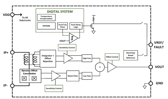

For example, the ACS37030 (datasheet linked) integrates both Hall-effect and inductive coil sensing paths, combining their outputs to achieve a bandwidth extending up to 5 MHz. This minimizes noise as frequency increases and unlocks rapid response times of approximately 40 ns. Its compact SOIC package incorporates a 3,500 VRMS isolation barrier that enables it to handle operational voltages up to 840 VRMS for basic isolation or 420 VRMS for reinforced applications.
Functional block diagram of the ACS37032
Functional block diagram of the ACS37032. Image used courtesy of Allegro Microsystems

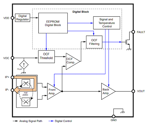

The ACS37220 (datasheet linked) targets high-current applications with its ultra-low internal conductor resistance of less than 100 μΩ. Its 7-pin QFN package, measuring 4 mm × 4 mm, supports current sensing ranges of up to ±200 A with a 150-kHz bandwidth.
Allegro’s proprietary differential Hall plate technology enables exceptional immunity to common-mode magnetic fields for improved accuracy in noisy environments. For these reasons, Allegro is positioning the ACS37220 as a solution for applications requiring high-current monitoring, such as DC-DC converters, solar inverters, and variable frequency drives.
Functional block diagram of the ACS37220
Functional block diagram of the ACS37220. Image used courtesy of Allegro Microsystems

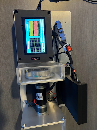

Allegro’s demonstration at CES 2025
Allegro’s demonstration at CES 2025 shows the current measurement accuracy of the new current sensors.
Magnetic sensing, as employed in the ACS37030 and ACS37220, offers a fundamentally lossless alternative. These sensors use Hall-effect and inductive coil technologies to measure current without requiring a direct electrical connection to the primary conductor. Such an approach eliminates resistive losses and significantly enhances thermal stability. Additionally, magnetic sensors are inherently isolated, reducing the need for complex isolation circuitry often required with shunt-based systems.
