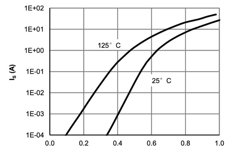

A notable feature of the αMOS E2 platform is the robustness of its body diode. Specifically, AOS engineered the body diode to withstand reverse recovery current slew rates of 1300 A/µs at a junction temperature of 150°C under 80 A forward current. The diode also features a typical forward voltage of 0.95 V at 20 A and a reverse recovery charge of 1.2 µC.
AOTL037V60DE2 body diode characteristics
AOTL037V60DE2 body diode characteristics. Image used courtesy of AOS

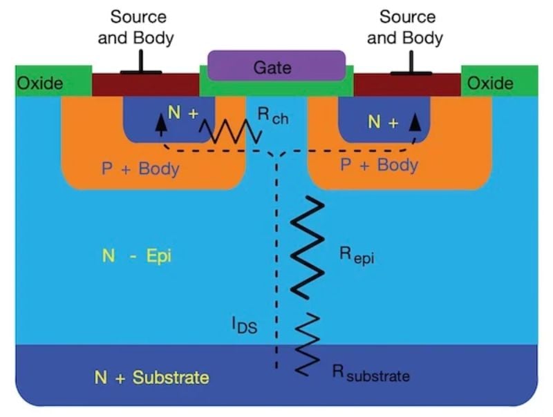

Super junction MOSFETs achieve low on-resistance at high breakdown voltages by replacing the uniformly doped drift region of conventional MOSFETs with alternating p- and n-type pillars. This charge-balanced structure reduces drift resistance while sustaining high electric fields. As a result, designers can lower conduction losses without resorting to larger die sizes.
However, the super junction structure introduces trade-offs. The body diode formed by the p-body and n-drift regions can store significant charge during conduction. When reverse-biased, this stored charge must be removed, leading to reverse recovery current that can stress the MOSFET and the surrounding circuitry. In high-power systems operating under hard commutation, reverse recovery characteristics significantly influence reliability margins.
The layout of a traditional planar MOSFET
The layout of a traditional planar MOSFET. Image used courtesy of Vishay
