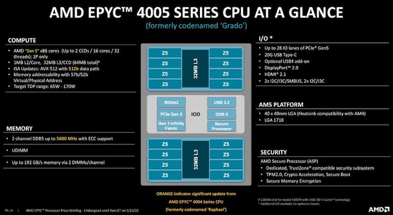

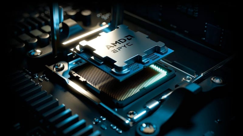

AMD has introduced the latest member of the EPYC CPU line, the 4005 series. The new series comes with six to 16 Zen 5 cores running from 3 GHz up to 5.7 GHz and up to 128 MB of L3 cache. I/O comes in the form of two-channel DDR5 ECC and up to 28 lanes of Gen 5 PCIe. As AM5 socket devices, the 4005 series enables easier migration from the prior EPYC 4004 series CPUs.
AMD EPYC 4005 CPU

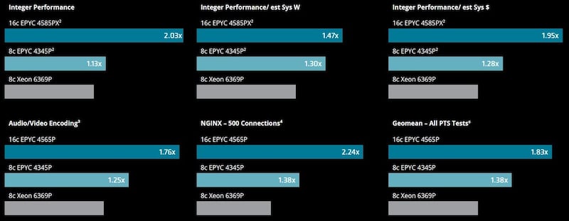

Going Toe to Toe With Xeon
AMD pits the EPYC 4005 CPUs most directly against Intel Xeon E-2400 and 6300P CPUs. While the Intel CPUs are price competitive with the EPYC 4005, the 4005 cuts the price per core to $40–$44 compared to the Xeon’s $53–$84 per core. The EPYC 4005 series contains between six and 16 cores compared to the Xeon E-2400 and 6300P’s four to eight cores. According to AMD, tests run on the Phoronix test suite showed the EPYC 4565P's 16-core besting the top-of-stack, sixth-generation Intel Xeon 6300P by 1.83x1.
Performance benchmarks vs. comparable Intel Xeon CPU
Performance benchmarks vs. comparable Intel Xeon CPU.
AMD also reports 4005 performance gains over Xeon’s AVX2. AVX is a multiprocessing taxonomy that allows a single instruction to act on multiple data (SIMD) points simultaneously. AVX2 delivers 256 bits of SIMD while the EPYC 4005 ups that to AVX-512. This AVX-512, along with simultaneous multi-threading (SMT), gives the AMD processors an advantage in memory and I/O intensive operations.

AMD EPYC 4005 series CPU block diagram
AMD EPYC 4005 series CPU block diagram.
The 4005 is also well-suited to data-intensive applications such as web server hosting, content creation, and small business AI applications, with its high core count, generous PCIe I/O, and DDR5 at up to 5,600 MHz. The series' multi-threaded operation can also serve computationally intensive applications such as code compiling and computer vision applications.
