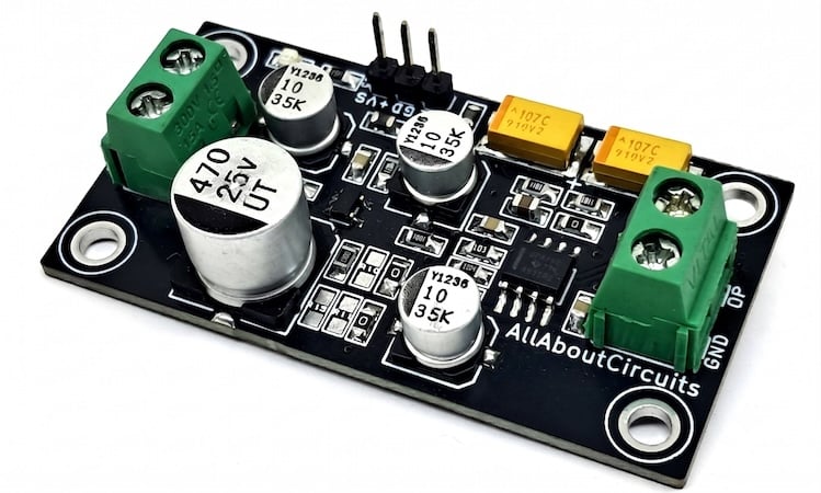

Figure 1 shows the fully assembled board. The circuit combines a discrete JFE150 N-channel junction field-effect transistor (JFET) first stage with a Texas Instruments OPA202 precision op-amp second stage.
Figure 1. Assembled ultra-low-noise pre-amp PCB.
The board operates from a single 12 V DC supply by default, with an option for dual-supply operation via component substitution. Screw terminals are provided for signal input (CN2) and output (CN3). A 3-pin header (CN1) accepts the power supply connections.

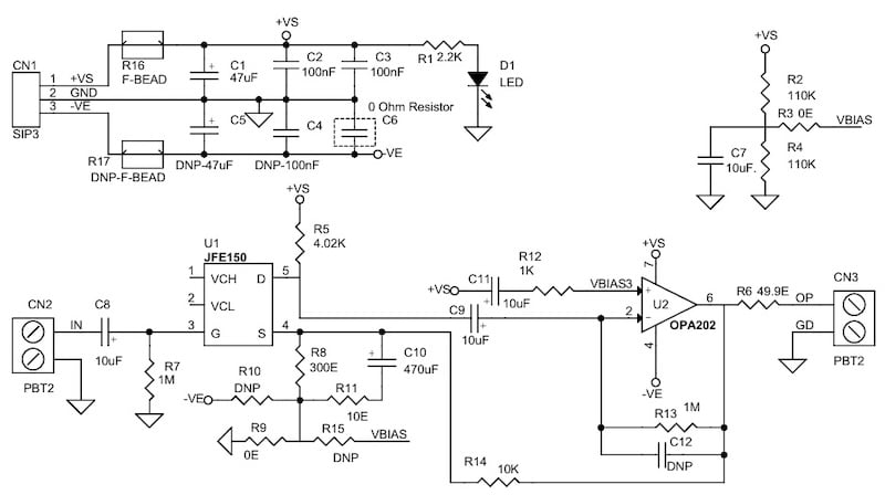

Figure 2 shows the schematic for the ultra-low-noise pre-amp module.
Figure 2. Schematic for the Ultra-Low-Noise Pre-Amp.
Figure 2. Schematic for the ultra-low-noise pre-amp.
The input signal is AC-coupled through C8 (10 µF) to the gate of U1 (JFE150). Resistor R7 (1 MΩ) sets the DC gate bias.
The JFE150's drain current is proportional to the gate voltage: IDS = gm × VGS. Therefore, it is an effective current-controlled transconductance element. The DC drain bias is set by R5 (4.02 kΩ), which is connected to the +VS rail.
The OPA202 (U2) is configured as a transimpedance amplifier. Its inverting input is driven by the JFET drain current, and feedback resistor R13 (1 MΩ) sets the transimpedance gain.
The non-inverting input is biased by a resistor divider (R2 and R4, both 110 kΩ) that sits at mid-supply (~6 V) in single-supply mode. This VBIAS shifts the OPA202 output DC level to approximately 6 V, keeping it within its linear range on a single rail.
Output isolation resistor R6 (49.9 Ω) improves stability when driving capacitive loads above 1 nF. It can be removed if no capacitive load drive is required.
Power-supply filtering is handled by a ferrite bead (R16, 600 Ω at 100 MHz) in series with the supply rail, supplemented by bulk (C1, 47 µF tantalum) and bypass capacitors (C2, C3, 100 nF each).

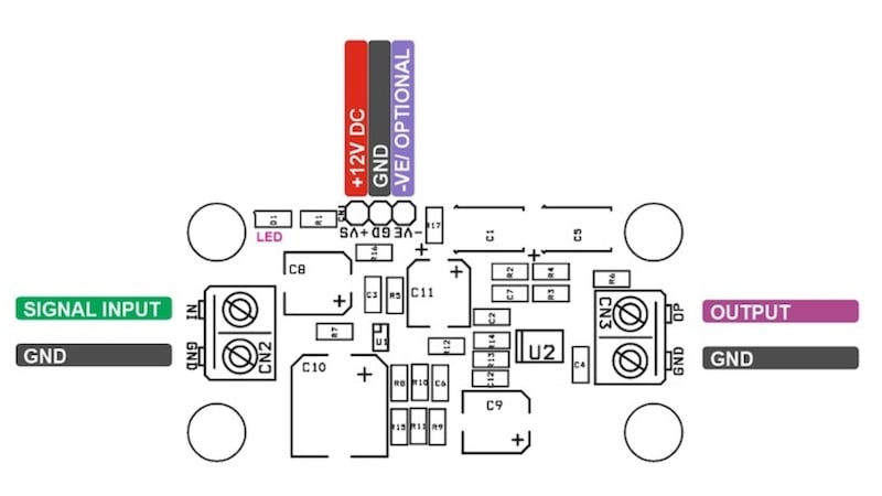

Connections
The connection diagram in Figure 3 shows all input and output assignments.
Figure 3. Connection diagram for the Ultra-Low-Noise Pre-Amp.
Figure 3. Connection diagram for the ultra-low-noise pre-amp.
CN1 — Power Header (3-pin, 2.54 mm pitch):
  • Pin 1 = +VS (12 VDC)
  • Pin 2 = GND
  • Pin 3 = −VE (optional, dual-supply operation only)
CN2 — Signal Input (2-pin screw terminal, 5.08 mm pitch):
  • Pin 1 = Signal Input (VIN)
  • Pin 2 = GND
CN3 — Signal Output (2-pin screw terminal, 5.08 mm pitch):
  • Pin 1 = Signal Output (VOUT)
  • Pin 2 = GND
D1 — Power LED:
  • Illuminates when +VS is applied

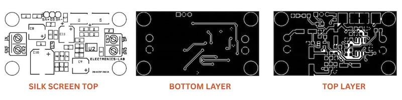

PCB Files
Figure 4. PCB layout: top silk screen, bottom copper layer, top copper
layer.
Figure 4. PCB layout: top silk screen, bottom copper layer, top copper layer.
Ultra-Low-Noise Pre-Amp Module Gerber Files
You can download the layout files for this project here:
Ultra-Low-Noise Pre-Amp Gerber Files
