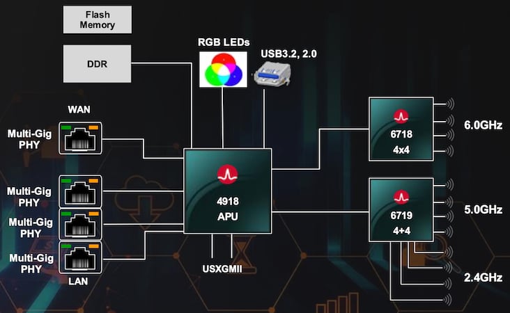

Block diagram of the BCM4918
Block diagram of the BCM4918.
That combination is a practical answer to two real design pressures.
First, as gateways add more software features—security inspection, parental controls, application prioritization, and mesh coordination—general-purpose CPU cycles get eaten by packet movement and encryption. Offload engines that can bypass the CPU for routine traffic free up headroom for higher-level analytics and control loops.
Second, if vendors actually want to run local inference in the router, they need predictable access to compute and memory bandwidth that doesn’t vanish whenever network load spikes. Broadcom is effectively presenting BCM4918 as a way to run AI-assisted optimization and management without turning the AP into a space heater or needing a separate companion AI chip.
On the integration front, Broadcom designed the BCM4918 to reduce system sprawl. The device's brief calls out integrated multi-gigabit Ethernet PHY interfaces, advanced memory interfaces, quad PCIe Gen3 ports, dual USB ports, and secure boot with enhanced encryption support. It is packaged as a 19 mm x 19 mm FCBGA part rated for 0°C to 70°C, consistent with high-end residential equipment that still needs a sensible thermal envelope.

What’s most notable about this platform is the way these parts fit together. The company describes a unified compute-and-connectivity architecture in which the BCM4918 provides the compute, security, and offload foundation, while the BCM6714/BCM6719 provides integrated dual-band RF and telemetry. For tri-band systems, Broadcom points to pairing these new dual-band devices with its previously announced BCM6718 Wi-Fi 8 radio to cover 2.4 GHz, 5 GHz, and 6 GHz with coordinated behavior across bands.
