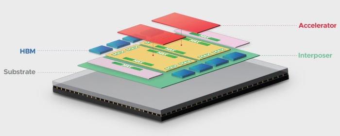

In the diagram below, the processing unit chiplets of the XDSiP platform are depicted in red.
Rendering of XPU utilizing XDSiP platform architecture
Rendering of XPU utilizing XDSiP platform architecture.
These can be any ultra-high-performance accelerators such as graphic processing units (GPUs), tensor processing units (TPUs), or application-specific integrated circuits (ASICs). The yellow base die chiplets can contain more processing circuitry, SRAM, network interconnect (NIC), or other custom circuitry. The accelerator and base die are connected face to face. The HBM stacks (in blue) surround the processing chiplets. Conventional 2.5D looks very similar to this but does not have the stacked accelerator chiplets.

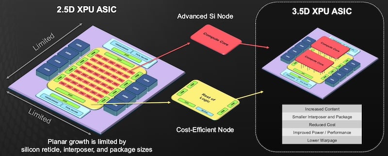

The move to a 3.5D XPU ASIC
The move to a 3.5D XPU ASIC affords computing performance growth.
Broadcom's approach utilizes both design and software to ensure thermal performance. The “3.5D” architecture combines 2.5D chiplet structure with 3D stacked die and a face-to-face (F2F) processor core interconnect configuration. With F2F, the most critical chiplets are stacked with their top sides facing each other. One die will be oriented right side up and the next in the stack up will be upside down. This arrangement enables shorter interconnect distances and faster data transfer with fewer artifacts. Interconnects can be improved by placing the chiplets facing each other and using hybrid copper-to-copper bonding (HCB). Copper pillars extend from each face to directly connect.
