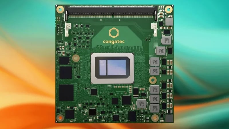

Congatec recently introduced the Conga-TC300 COM Express Compact module, built on Intel Core Series 3 processors. The device targets low-power, cost-sensitive edge computing applications that now require integrated AI capabilities. Congatec claims the module may be useful for systems that need more processing power than legacy entry-level platforms, while still meeting constrained power and thermal requirements.
The Conga-TC300 COM Express Compact module
The Conga-TC300 COM Express Compact module with Intel Core Series 3 processors for edge AI and embedded applications.
The module adds a dedicated NPU and a hybrid CPU architecture to the entry-level x86 space, enabling systems based on Intel Atom or Celeron platforms to add AI acceleration without a full redesign. Along with scalable performance, standard industrial interfaces, and available software options, it can be used as a relatively straightforward upgrade for embedded and edge systems.

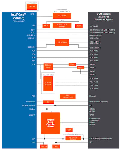

Congatec’s new module supports up to 64 GB of DDR5 memory at up to 6400 MT/s, with optional in-band ECC for improved reliability. Storage options include onboard UFS 3.1, and connectivity via 2.5 GbE, with optional TSN and TCC support for time-sensitive applications.
Block diagram for the conga-TC300
Block diagram for the Conga-TC300.
Peripheral expansion is handled through up to eight PCIe lanes, eliminating the need for an external PCIe switch in many cases and simplifying carrier board design. Additional interfaces include USB4, USB 3.2, SATA, UART, GPIO, and common embedded buses such as I2C and SPI, making the module suitable for a wide range of industrial and edge applications.
