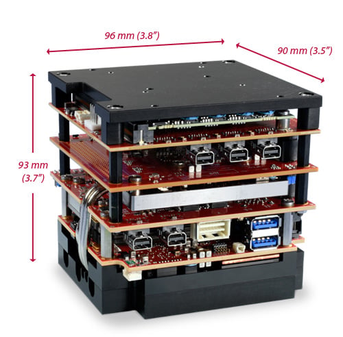

Versalogic designed the Sabertooth AI Connect, a ruggedized edge computer, for the harshest of industrial environments. It can withstand temperature extremes of -40℃ to 85℃ (-40℉ to 185℉) and meets MIL-STD-202H specifications for shock and vibration. The broad temperature range and resistance to vibration make it a good fit for aerospace, defense, energy, medical, and other critical industries. Versalogic says that the Sabertooth AI Connect, like its other devices, is desgind for long term availabilty, typically a 10+ year product lifecycle.
Sabertooth AI Connect packs AI-enhanced computing into a compact package. Image used courtesy of Versalogic
In terms of computing power, the Sabertooth AI is powered by the hex-core Intel Xeon-E CPU and the Nvidia RTX 2000 ADA GPU. The combination of these processors enables generative AI, including 3D rendering and high-performance interfacing. More specifically, the Ada Lovelace architecture found in the GPU supports 3072 CUDA cores, 96 Tensor cores, and 24 RT cores. All of this processing capability means that the floating point performance can be up to 12.99 TFLOPs.
The edge computer is equipped with dual, independent, 10 Gbit Ethernet ports as well as three mini DP++ ports for video streaming at 8k.

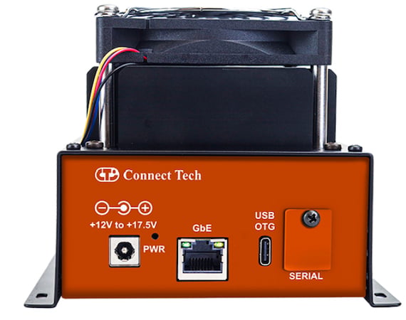

The Essential EdgeAI Network Node combines the Nvidia Jetson system-on-module (SOM) platform with a small physical footprint. Designed for edge computing in industrial settings, these nodes are powered by 12 V to 17.5 V DC and communicate via Gigabit Ethernet connection, UART, or USB 3.2. They operate “headless,” meaning there is no display, further reducing the space requirements.
Connect Tech Essential EdgeAI Network Node
Connect Tech Essential EdgeAI Network Node. Image used courtesy of Connect Tech
These network nodes are designed to handle generative AI applications, including images and video processing. The platform supports machine vision and machine learning algorithm development and control responses, not simply pattern recognition.
Priced for high volumes and backed with the Connect Tech Board Support Package (BSP), the Essential EdgeAI Network Nodes are fully supported from the start of installation through its full deployment.
