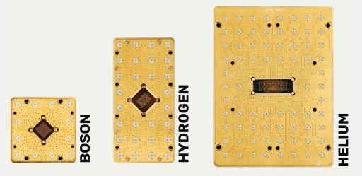

Alice & Bob’s Boson cat qubit joins other investments the company is making in quantum computing, including its multi-qubit chips Hydrogen, which detects quantum errors, and Helium, which exponentially removes phase flips through error correction.
Boson Hydrogen Helium
Boson alongside Alice & Bob's other line-up of multi-qubit chips, Hydrogen and Helium.

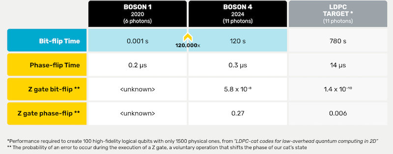

Improvements in bit-flip time from Alice & Bob’s Boson 1 to Boson 4
Improvements in bit-flip time from Alice & Bob’s Boson 1 to Boson 4 highlight the trade-off of exponentially decreasing bit-flip errors while linearly increasing phase-flip errors.
Cat qubits present an interesting trade-off in quantum computing that is not observed in superconducting bits. Cat qubits can exponentially decrease in bit-flip error rates and linearly increase in phase-flip error rates, while superconducting bits experience both bit-flip and phase-flip errors at higher rates.
The Boson 4 Tackles Bit-Flip Errors
Two general errors affect qubits in quantum computers: bit-flip errors and phase-flip errors. Alice & Bob aim to improve bit-flip errors with Boson 4 and plan to address phase-flip errors in the future. A bit-flip error changes the state of a qubit from |0⟩ to |1⟩ or vice versa, similar to classic computing when a bit flips from 0 to 1 or 1 to 0.
Dozens of bit-flip and phase-flip errors occur per second in quantum computing. Boson 4 extends the bit-flip time to well over seven minutes. This is a 4x improvement from state-of-the-art superconducting qubits, setting a new world record for bit-flip lifetime.
